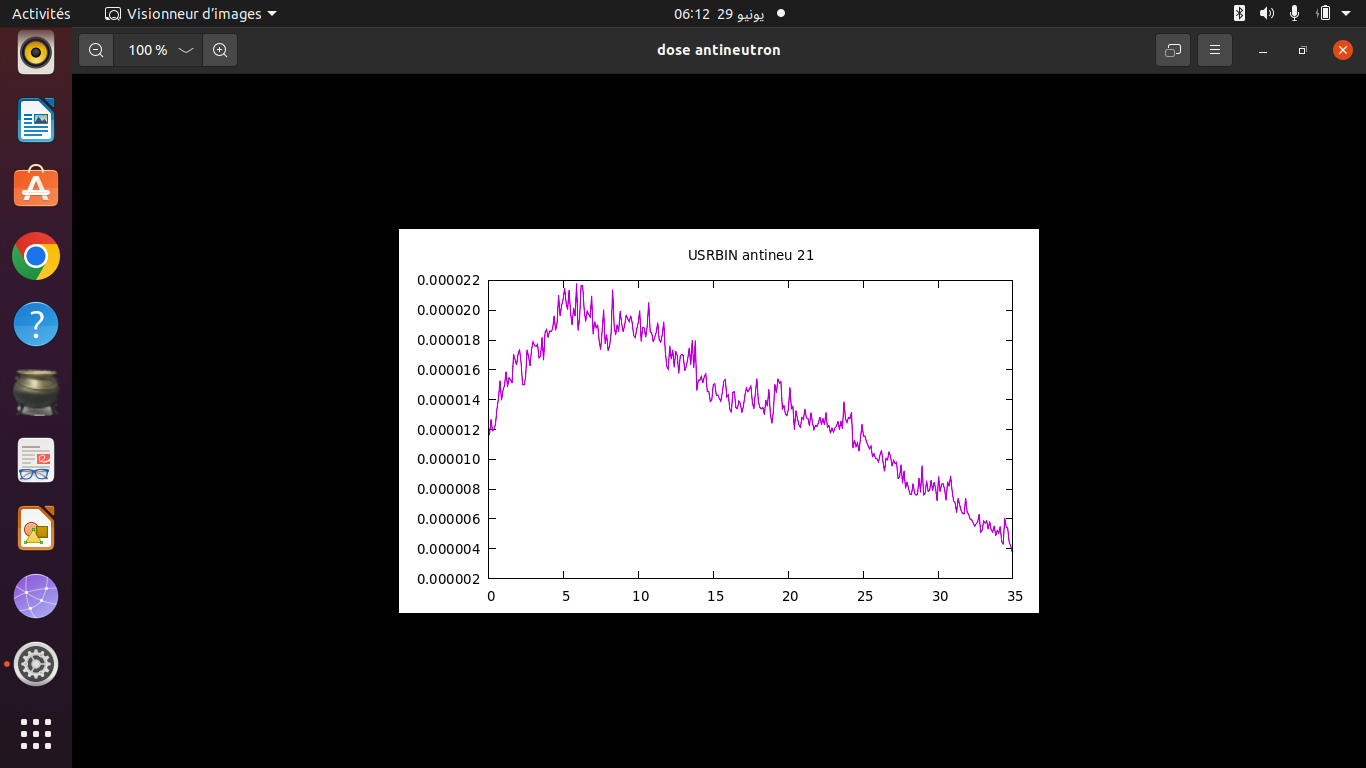

Hello dear expert. I simulate the dose deposition of a monoenergetic antineutton beam in ’ parallelepipedic phantom of water. I get the curve attached. I want to get it without zig zag what to do? Thank you for your availability
Dear @bakodeo,
Not having your inputfile, I cannot be sure, but I would say that your plot suffers of large statistical uncertainty, i.e. you need to run more primaries.

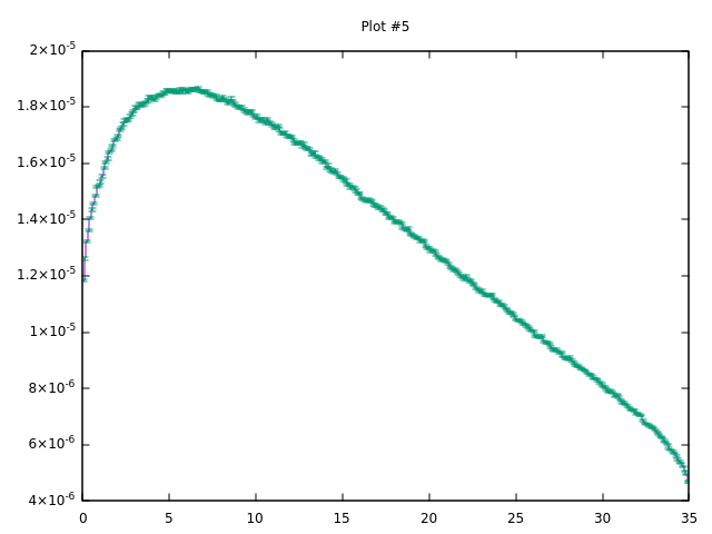

Dear @bakodeo,
I was able to run your input out of the box. I run 1 million primaries and obtained the following plot. It confirm the diagnosis that you did not run your simulation with a sufficient number of primaries.
