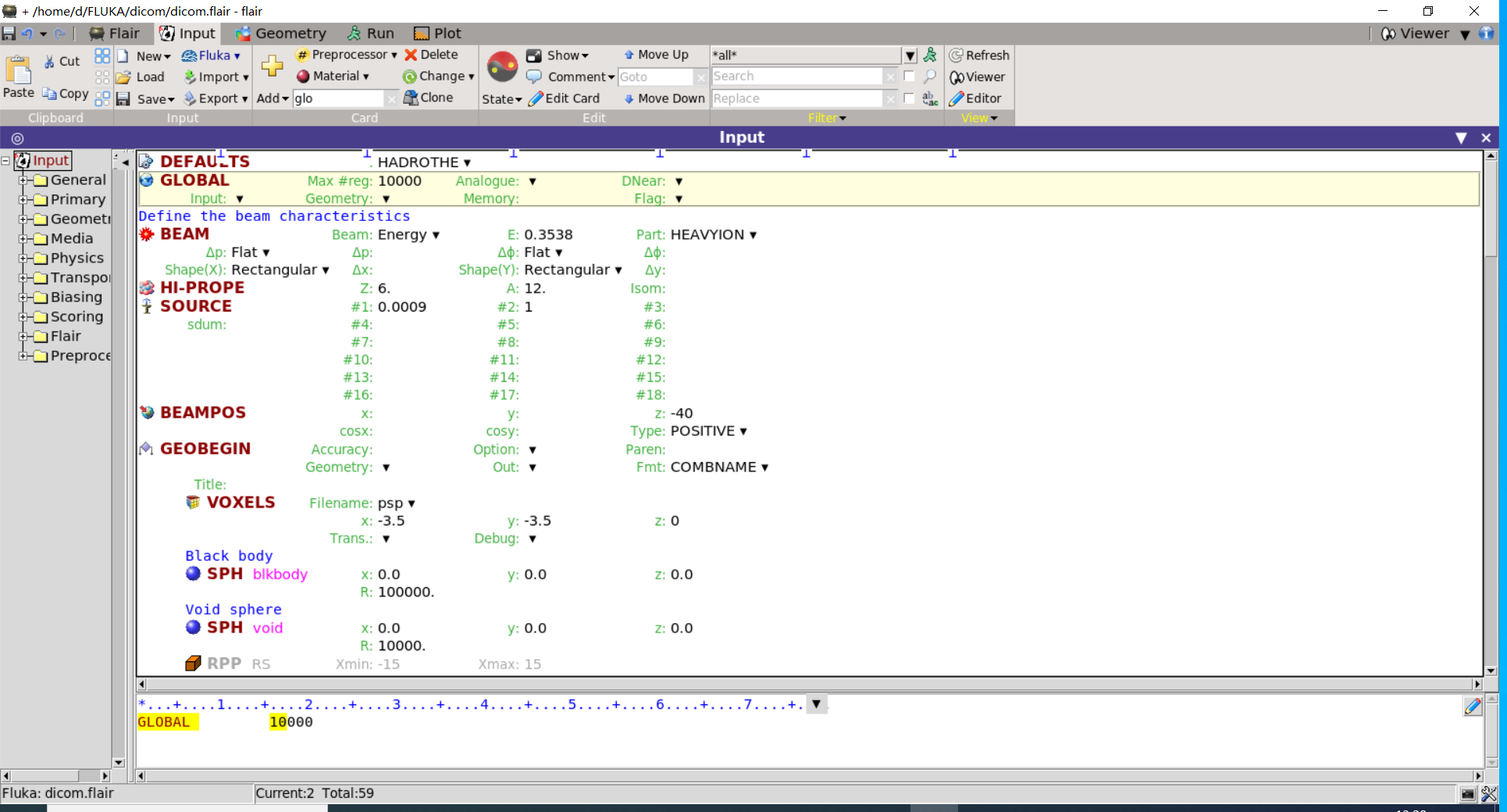

I used the Dicom function to generate a voxel model in Flair, but there were too many regions in this voxel model, which makes it unable to run. To this end, I added the global card, but it still doesn’t work properly.
if you look at the error message it says “GLOBAL out of order”. This does not indicate a memory problem but rather a problem of sequence of the cards. The GLOBAL card must be at the top of the input before other cards. See:
