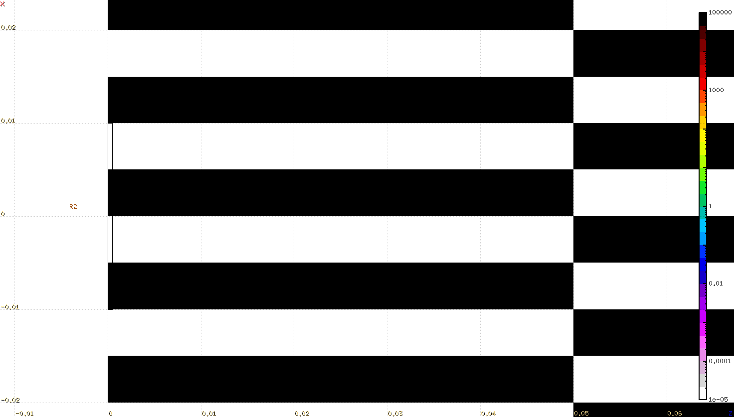

- In menoralvo.inp: the usrbin that you are using is too big compared to the size of your water target. you can observe it in the following picture:
Here you can observe the bins of your usrbin, where only the first bins in z occupy one small part of your target. Try to redefine it according to your needs. You can see an example here:
Where I defined this usrbin:

- In menosenergia.inp you have a similar problem defining the usrbin, but with an extra due to the energy for your proton beam:
Here, you can see that your protons are not even moving beyond your first bins in z again.
Define the usrbin for this case to have a resolution according to the problem.
