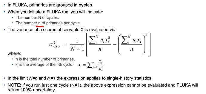

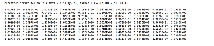

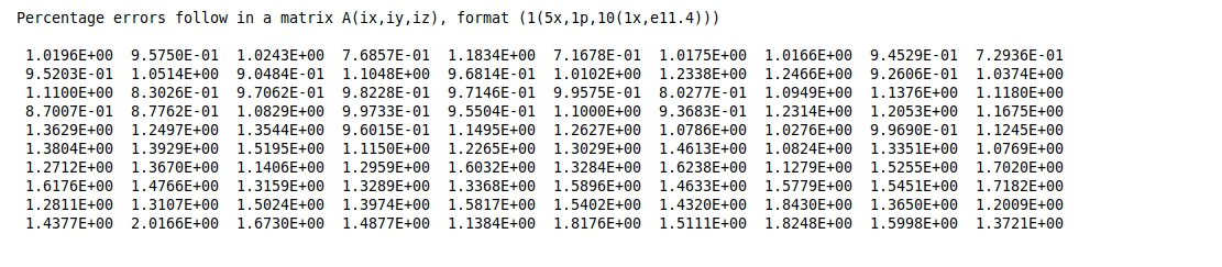

Do you mean increasing the value of ni? That is indeed effective. However, when I set ni to 4e8, with five cycles and five parallel runs, under the bin size as shown in the figure, the statistical error I get is around 1%. When I continue to increase ni, the statistical error no longer decreases. Is this normal?
Up to which value did you increase it? Consider that the error is expected to decrease as the square root of the increase ratio.
More substantially, I’d judge a 1% statistical error as a satisfactory achievement, considering that at that point the result uncertainty gets dominated by the systematic error, which has many sources.

Let me explain the results I want to obtain and some of the methods I have thought about, and I hope you can give some suggestions. I hope to obtain the dose distribution in a 0.3×0.3 cm plane at a depth of 30 cm along the central axis of the water tank. I use the usrbin-DOSE card with a 0.3 cubic centimeter bin, and the statistical error needs to be reduced to 0.3%. To this end, I have taken the following actions:
  1. Increase the number of particles (photons) recorded in the txt phase-space file to ensure that there are enough particles in each bin.
  2. Increase the number of particle histories during simulation.
  3. Increase the number of simulation cycles.
The following are some methods that I think can help reduce statistical errors:
  1. Lower the production and transport thresholds for photons and electrons.
  2. Use the BIASING card to set a larger weight in the scoring area.
I would like to get your suggestions on whether the above methods are effective or whether there are other methods to reduce statistical errors.
Lowering the production and transport thresholds for photons and electrons may increase the accuracy of the result (and the required CPU time), but may not necessarily reduce the statistical error.
You do not need any biasing for a scoring area that is in the core of the radiation propagation.
You got ~1% statistical errors with 10 billions primaries (4e8x5x5). My question was up to which value you further increased your statistics.
When I increased the number of particles from (4e7×5×5) to (4e8×5×5), the statistical error decreased to approximately one-third of the original value. However, when further increasing the number of simulated particles from (4e8×5×5) to (4e9×5×5), the statistical error showed no significant reduction compared to that of (4e8×5×5).
