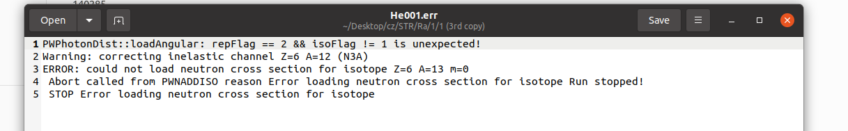

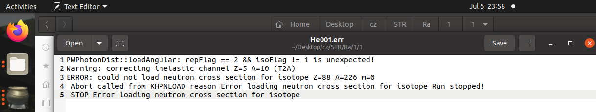

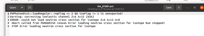

I am currently conducting an electron beam bombardment to convert the target material tungsten into photons, which then undergo a 226Ra (g, n) 225Ra reaction and finally decay to 225Ac. I have encountered the following error message

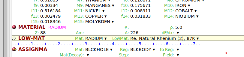

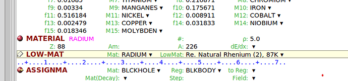

When I added the LOW-MAT card, the reaction occurred. However, I think this utilizes the low-energy neutron cross-section that does not belong to Ra. I realize that the calculation result is unreasonable. If so, how should I modify it?

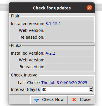

Dear Zhiyu,
please update your FLUKA and Flair to the latest versions.
Since the release of 4-2.2 we introduced a new point-wise treatment of low energy neutrons, which support almost all isotopes.

Dear expert,
I don’t quite understand. My current version is only 4-2.2. Why do I still need to update it?
Sorry to trouble you.
Dear Zhiyu.
This feature was released in version 4-3.0.
And support is only provided for the latest release, which is 4-5.0.

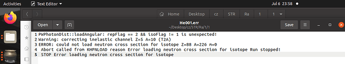

I installed the latest software as per your suggestion, but I encountered the following error when calculating.
Ra.inp (3.9 KB)
Zn.inp (10.6 KB)
I am calculating the reaction processes of 226Ra(γ, n)225Ra and 68Zn(γ, p)67Cu. Different reactions encountering different neutron libraries will result in different errors. For instance, Re and Zn will report errors in CENDL-31 and JENDL-4.0
This is because my reaction is quite unique. There are no low-energy neutron cross-sections of the corresponding materials in some of the libraries, so an error is reported?
Dear zhiyu xuxzy66,
due to changes in version 4.3-0 and later, you will have to download and install the neutron libraries separately, see here:

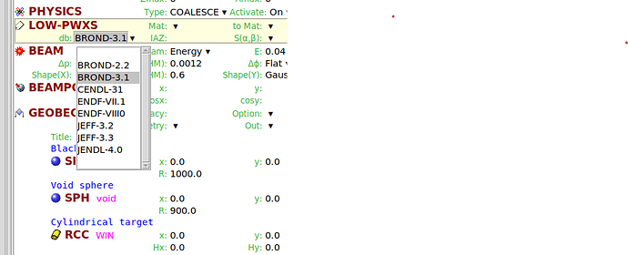

I have downloaded some of the neutron libraries as shown in the figure. Selecting some neutron libraries will cause the calculation to fail, which is exactly what I want to ask you for advice
Meanwhile, I would also like to ask, if the latest version introduced a new point-wise treatment of low energy neutrons, then in what circumstances should LOW-MAT be used?
  • LOW-MAT is not needed with the PointWise.
  • The default neutron library for FLUKA is the JEFF-3.3. I would recommend to use that one

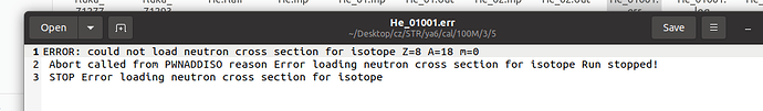

Dear expert

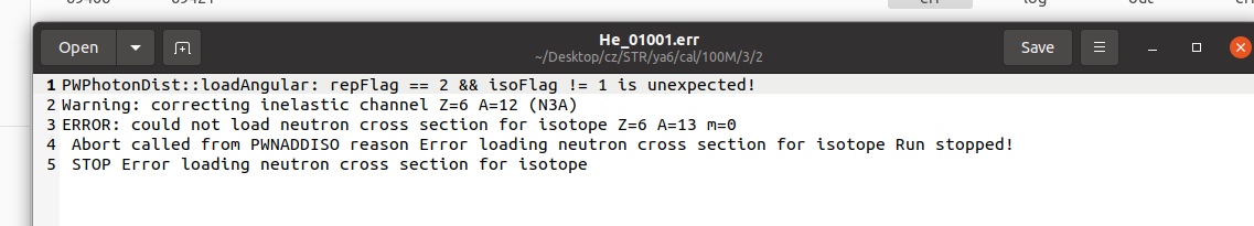

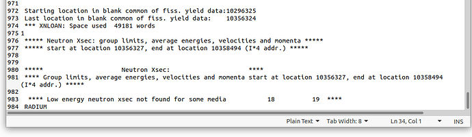

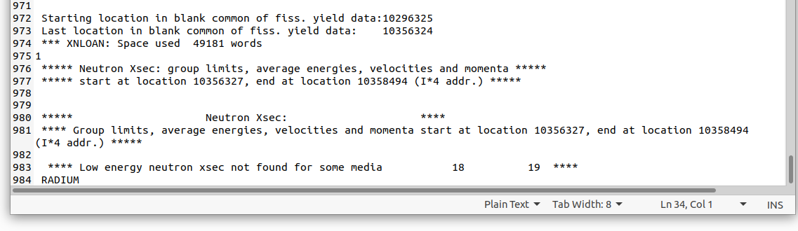

I am calculating the reaction processes of 226Ra(γ, n)225Ra and 68Zn(γ, p)67Cu, and studying the influence of different neutron libraries on the calculation results. I have found that 226Ra(γ, n)225Ra will have calculation errors when encountering the BROND-3.1 and CENDL-31 neutron libraries. 68Zn(γ, p)67Cu will have computational errors when encountering CENDL-31 and JENDL-4.0 libraries. The error report is as follows:
Ra.inp (3.9 KB)
Zn.inp (10.6 KB)
Could it be that because my reaction was unique and there were no low-energy neutron cross-sections of the corresponding materials in some libraries, an error was reported?
For (γ,n) and (γ,p) processes you don’t need any of the above databases.
These databases are only used for neutron induced reactions E<20MeV
I would recommand to use the default library JEFF-3.3 for neutrons (so the code will not complain for missing isotopes).

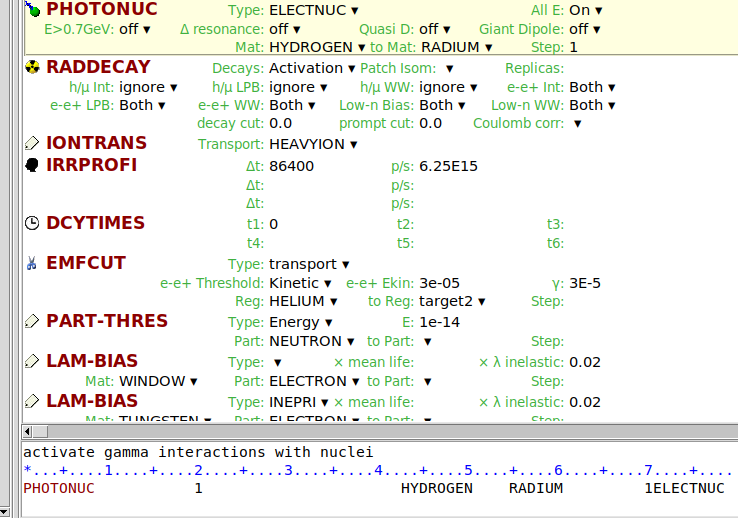

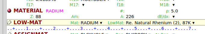

226Ra (γ, n) 225Ra generates neutrons, which may affect other reactions in the experiment and thus influence the generation of other nuclides. I wanted to simulate the same result as in practice as possible, so I activated the neutron library. Meanwhile, when I turned off the neutron library, FLUKA would automatically open the LOW-MAT card for me. Does this card need to be kept
The Settings of my PHOTONUC card are as follows. According to the manual’s explanation, this should enable all energy levels of the photonuclear reaction. If I fail to enable it, could you please tell me how I should do it?
Dear Zhiyu,
Sorry for the delayed answer to your questions.
  1. The LOW-MAT card is not necessary if the point-wise neutron cross sections are in use
  1. You enabled the photo- and electronuclear interactions for the list of materials between Hydrogen and Radium.
    If you want it for all materials you can select @LASTMAT instead of RADIUM.
    If you want to enable only for Radium: Select Radium instead of Hydrogen and leave the To Mat: field empty.
