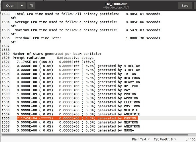

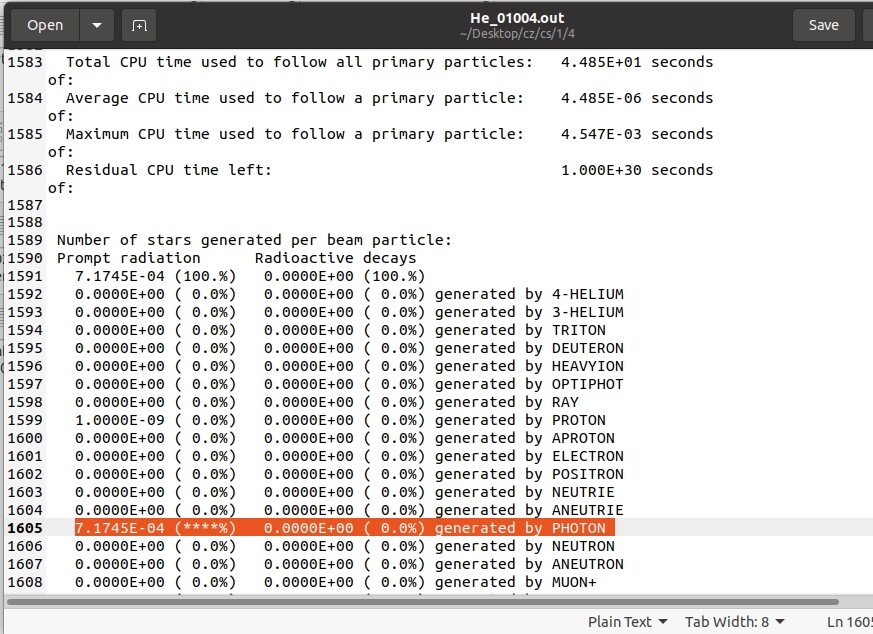

I made the modifications as per your suggestions and found the Number of stars generated per beam particle by PHOTON
He.inp (1.5 KB)
  1. I calculated the reaction cross-section of 68Zn(γ, p)67Cu as 2.29mb by dividing the proportion of 67 copper, 1.4886E-05, by 7.1839E-04 and then multiplying it by sigma. This is slightly higher than the cross-section I calculated through talys. I wonder if my calculation method is correct?
  2. Meanwhile, I would like to continue to ask why the value of Number of stars generated per beam particle by PHOTON, 7.1839E-04, is not equal to the sum of the proportions of all generated nuclides, 0.00074664. The values in different out files are similar but not the same. Which value should I adopt, or should I add up the values in out and take the average?
  3. Finally, I want to study the physical process of the 40MeV electron accelerator hitting the conversion target W to generate photons to irradiate 68 zinc to produce 67Cu. Is it unwise for me to turn on ELECTNUC? Or, when should I turn on ELECTNUC
  1. The value you found appears to be consistent with the FLUKA curve I previously provided, where you can find the desired cross section at multiple energies with no need to recalculate it.
  2. You should take the average over all cycles you used to produce the RESNUCLEi result.
  3. Since you had a photon beam, I told you to remove ELECTNUC for the only purpose to get the photon inelastic scattering length in the output table. Otherwise, you can always keep it. In fact, electronuclear reactions (activated by ELECTNUC together with photonuclear ones) play a role in case of thin targets, where the production of bremsstrahlung photons is limited.

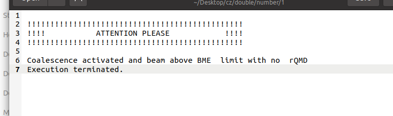

Thanks to your help, I successfully calculated the reaction cross-section, but I encountered problems in the subsequent calculation. Do you mean “The PEATHRES/IONSPLIT PHYSICS cards are obsolete since a while and should disappear from any input file”? After I deleted them, the calculation couldn’t run. May I ask what the problem is?
He.inp (13.2 KB)
Thank you very much!
Use the flukadpm executable, by selecting it in the Runs tab of Flair or adding the option -d to the rfluka command.
[Note that this is just an innocuous way to bypass the unjustified stop you met, which we will remove in the future.]
