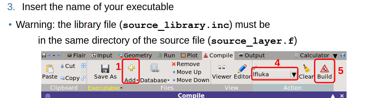

The same compilation process works well on my laptop (both via Flair compilation interface and the CLI $fff source_newgen.f command), and also I copied the source_library.inc to my working directory on the cluster as it’s suggested in the lecture:
Does anybody have an idea what might cause the errors and how can I fix them?
