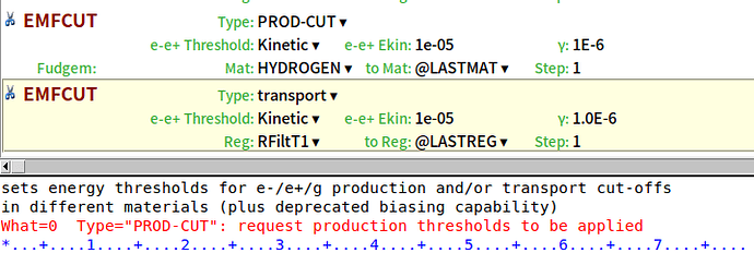

Thank you very much for your valuable suggestions. As requested, I have attached the complete .flair and .inp files here, hoping to provide more context for troubleshooting the issue.

I carefully reviewed the documentation and used FLAIR’s Edit Card function to set the corresponding parameter in the .inp file to -1.0e-5 (as specified in the manual, including the negative sign). However, two issues remain:
  1. The parameter change is not reflected in FLAIR’s card interface, despite being correctly updated in the .inp file.
    1746539888572
  2. The error persists, and the program continues to report the same issue.
    1746540524114
Given this, I wonder: Could there be minor discrepancies in FLAIR’s parsing of this card that do not interfere with FLUKA’s core functionality but cause inconsistencies in the interface or parameter handling?
Your further insights or guidance on this matter would be greatly appreciated. Please let me know if additional information or steps are needed on my end.
Thank you again for your assistance!

  • the negative sign simply means to use the kinetic energy rather than the total electron energy (mass + kinetic), and it is reflected in the Flair interface.
  • since I cannot reproduce the Flair warning, is it possible you are using an older version of Flair? If so, try updating and trying again. Another solution would be to completely delete the card and write it again, all from within Flair (looks like it is still thinking it is a PROD-CUT, rather than a transport)

thanks,this bug has been fixed in flair3.4-1
