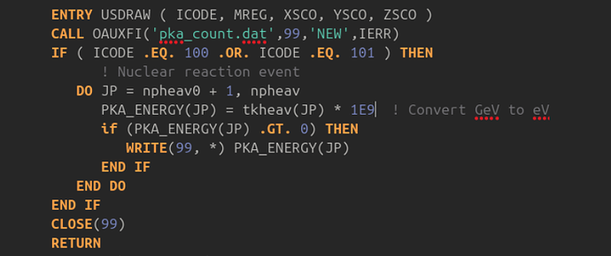

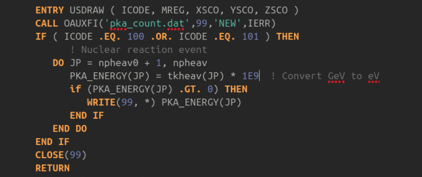

Dear Volodymyr,
I have revised my code as shown below and have also added the LAM-BIAS card settings accordingly. However, there is still no data in the dat file. Would it be necessary to further reduce the reaction length?
Additionally, I have a new question: The particles selected based on ICODE=100 and ICODE=101 are secondary particles, which include the PKA that I need. Is it possible to obtain data solely for PKA? Is there a precise definition of PKA in FLUKA, rather than just a general category of secondary particles?
Yingming
Dear Yingming,
Your issue here is that the new file is opened at every interaction instead of once:
      IF ( LFOPEN ) THEN
            LFOPEN = .FALSE.
            CALL OAUXFI('pka_count.dat',99,'NEW',IERR)
      END IF
where logical variable LFOPEN must be preserved via SAVE statement.
Also, PKA_ENERGY can be a single floating number value and not an array.
ICODE=100/101 includes secondaries from elastic and inelastic interaction. You should add ibres,icres,ekres to score residual nuclei rather than heavy fragments.
Unfortunately, FLUKA doesn’t have a dedicated PKA scoring, and I think residual nucleus from neutron impact fits this definition better.
With this logic, you will score all reactions and not only the first one. You can add ncase value, to see how many PKAs are generated per primary.
