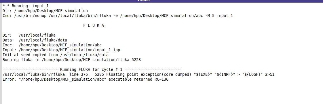

Thank you @adonadon for the reply. Adding LAM Bias, I am attaching my input here which gave me some error. It was working I guess, before I updated my ubuntu system to 22.04 version recently and moved to the new flair version as well. Also surprisingly, I cannot select ‘mass’ in the compound card. No matter how many times, I am clicking on the mass, it is remaining in the ATOM state.
I am not sure if I should post this query here itself. If required, please move it to a different thread.
Note: I have used .deb version of fluka and flair during installation.
input_1.flair (3.2 KB)
input_1.inp (4.6 KB)
Riya
Dear @riya,
First of all, it does not change because you have to add a ‘-’ in WHATS 1 and 3.
Screenshot from 2022-11-29 09-47-56
And second. The error you get is because you are not providing the information of the beam intensity (WHAT2 for your case) in the IRRPROFIle card.
