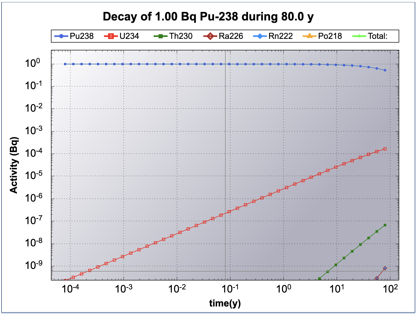

If you are just interested to calculate activities in a decay chain for specific decay times there might be easier ways to achieve this than using FLUKA, e.g. Nucleonica .
See this plot:
Still, if you want to do this with FLUKA, it has to be set up as I illustrate in the attached modified input file.
