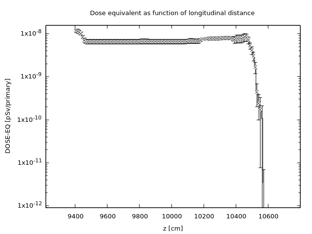

In principle, your file does not show any significant problem. I see that you decided to do a region importance biasing to enhance the probability of neutrons to penetrate deep. The problem is that within the first layer of concrete you stop all the neutrons. It is a lot of shielding indeed.
If your goal is to study neutron penetration at such depths, I recommend discretizing your geometry more finely and ramping up the importance binning in a smoother progression (e.g. 1, 2, 4, …). Keep in mind that you should not expect a fast simulation, since even a single meter of concrete already gives a transmission factor on the order of 10⁻³.
To better see this, you can do a 1D plot to observe the DOSE-EQ profile as a function of z:
