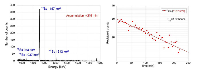

So i need to plot the similar figure as given below for different cooling period and calcute the yield and activity.

Is it like just plotting the decay time and yield of Sc-44 . If so how to calculate the detector efficiency to calculate the activity?

The simulation gives you the radionuclide yield and consequently its activity inside your calcium target. Which detector are you talking about? If you want to calculate a detector efficiency, you need to score the decay gammas in the detector region.
But note that, while in real life you need the detector efficiency to estimate the activity, in the simulation you directly get the ‘true’ activity in the target.
Ok i understand your point now. I could able to calculate the activity directly. I was talking about the gamma ray detector as they use that originally in the experiment.
