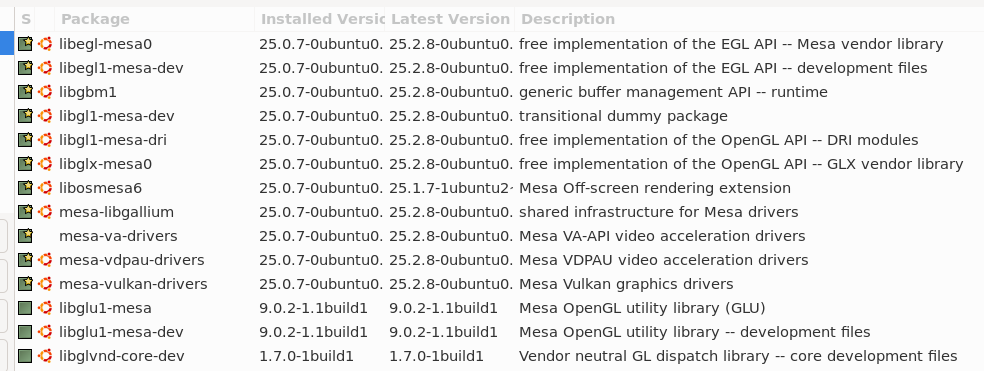

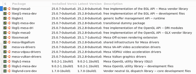

I also have WSL2 + discrete GPU card on my laptop:
lsb_release -a
No LSB modules are available.
Distributor ID: Ubuntu
Description: Ubuntu 24.04.3 LTS
Release: 24.04
Codename: noble
For me, it works with these packages:
