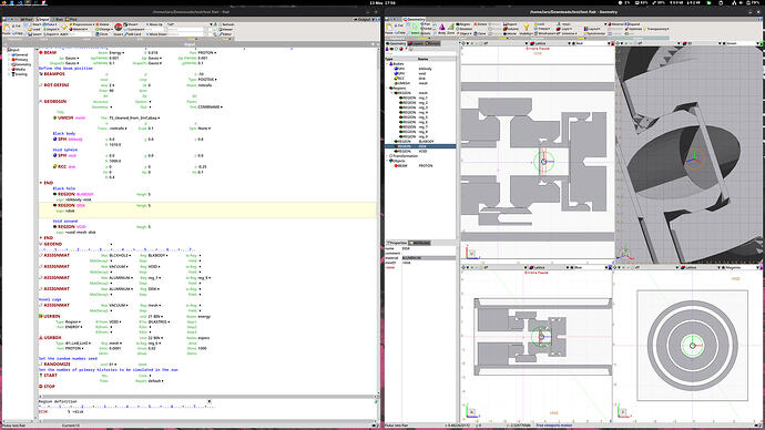

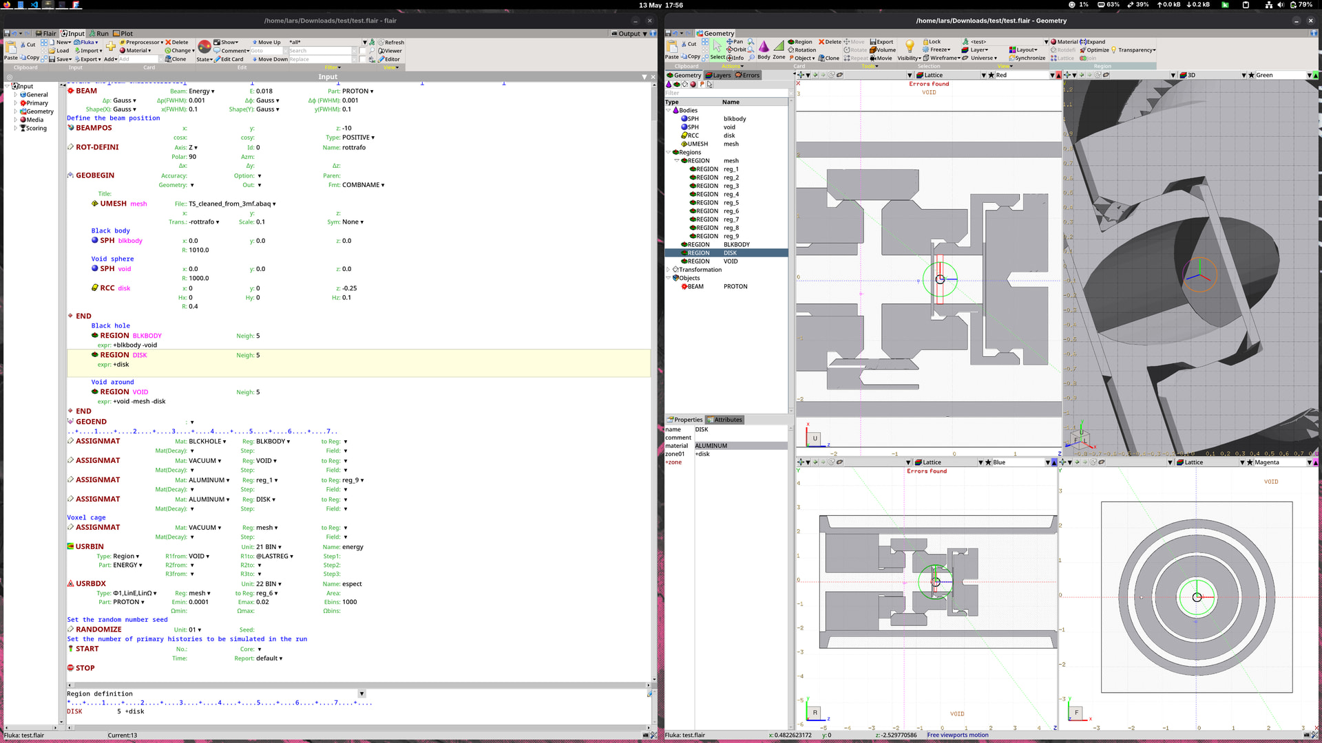

I import a CAD drawing via the UMESH card, using the new FLUKA_mesh_fix.py to convert and fix the geometry. The resulting geometry looks good. I am interested manly in the proton energy of our beam on a target, for this I would like to do different simulations with different thicknesses of degrader material.
Now I would like to add the degrader material as a normal RCC fluka geometry inside the volume of the umesh, such that I can change the degrader thickness via some scripting and run the simulation many times.
I this possible? how would I do that?
I tried to just add a RCC but the geometry does not render correctly.

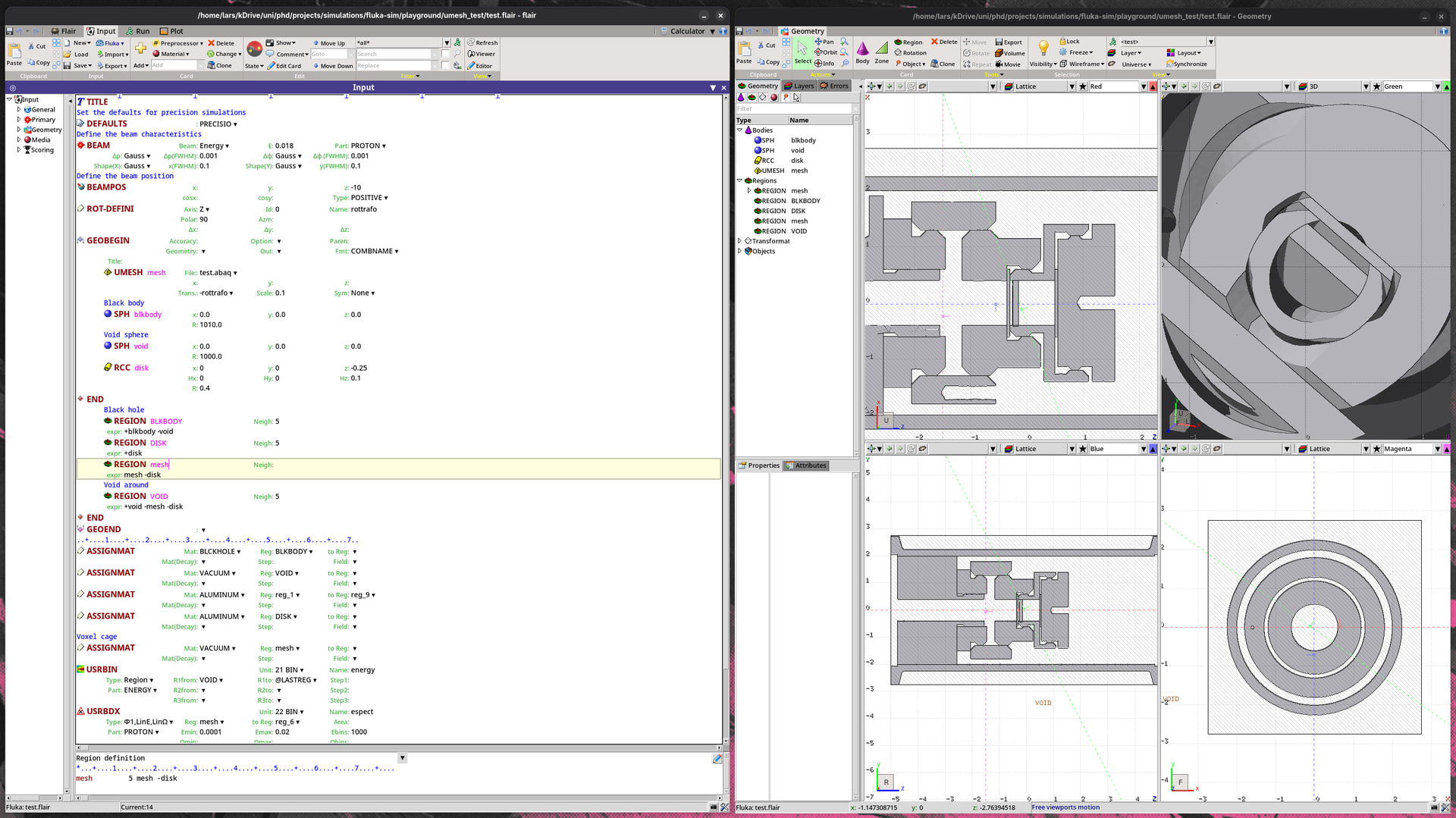

Dear @lars.eggimann ,
You are almost there.
Mesh region definition must be changed by adding a new region card with the same name as in UMESH card:
mesh 5 +mesh-disk
Dear Volodymyr
thank you! It worked like a charm!! :slight_smile:
