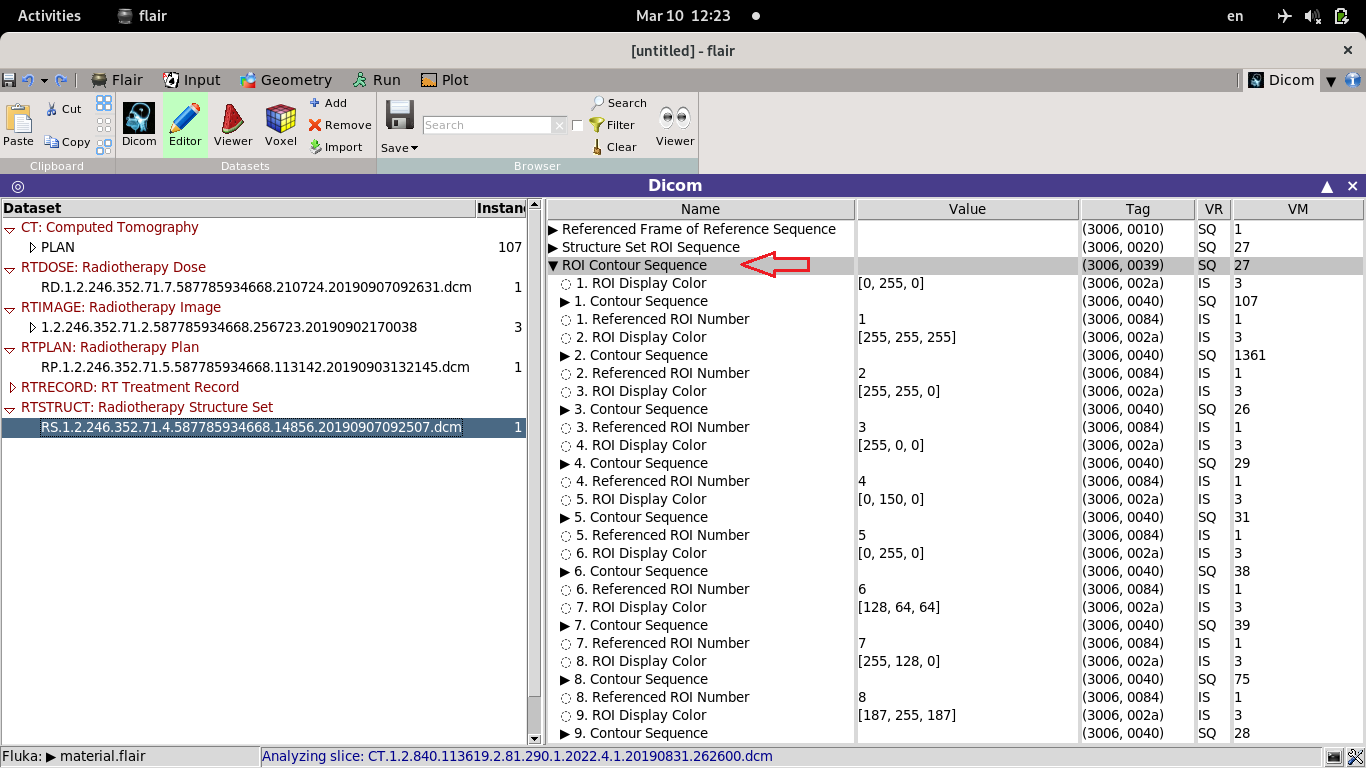

There is an error when I create voxel file.
Any help will be appreciated in advance.
Asghar
Could you please verify all sequence items in the ROI Contour Sequence have a corresponding Contour Sequence sequence.
Dear Vasilis,
It seems that 27th item does not have a corresponding Contour Sequence. An error message is issued when the relevant ROI is checked in the Dicom slices viewer.
Could you please suggest a solution to this problem?
Asghar
