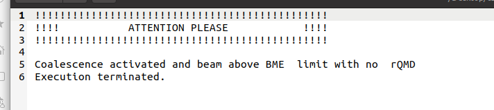

Currently, I want to compare the impact of bilateral and unilateral target shooting on the yield of nuclides. When conducting bilateral target shooting, I encountered the following error message
It ended with an error after I added the PHYSICS card

Dear Zhiyu,
indeed, the use of IONSPLIT card for Deutron treatment is obsolete, you should remove it.
To be able to run the simulation, you need to use the flukadpmexecutable, which includes the rQMD and DPMJET event generators.

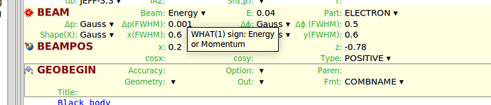

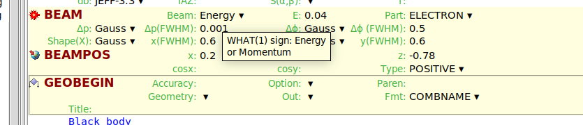

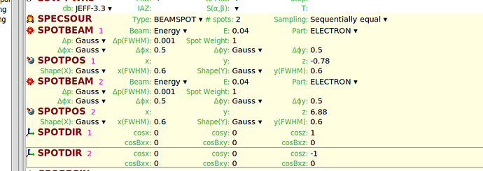

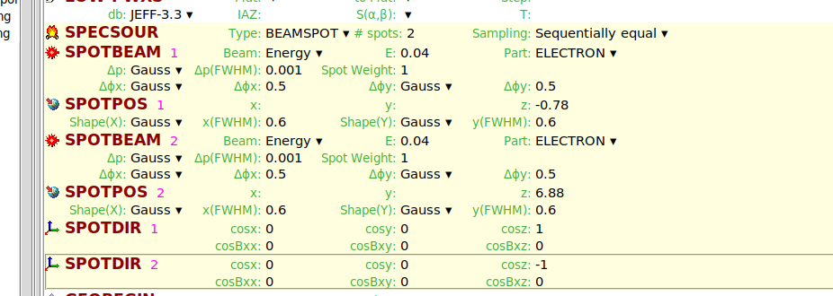

Dear expert, the PHYSICS cards of these two cases are the same, only the sources are diff
erent
This does not explain why in one case flukadpm is required and in the other it is not. If you want to clarify the issue, please upload the two input files entirely.

Thanks. I shall acknowledge that your screenshots above were actually already explaining the different behaviour: for case two (top screenshot, no BEAM card) the code takes the default BEAM card values (protons of 200 GeV/c momentum) for initialization purposes and concludes that coalescence may generate fragments (A>1) requiring RQMD/DPMJET to interact. Thereby, it stops and asks to use flukadpm (it doesn’t if you have PHYSICS/IONSPLIT, as an alternative to a proper interaction, but you shouldn’t, as already pointed out). In fact, you have 40 MeV electrons (as from SPOTBEAM), but the flukadpm requirement is unfortunately not lifted.
In the other case (one, BEAM card with 40 MeV electrons), the above requirement rightly doesn’t apply.
