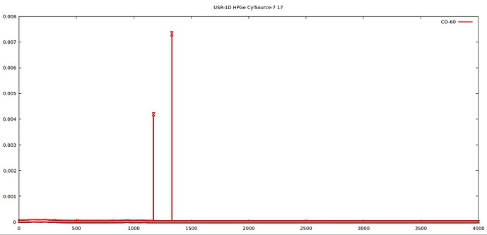

As shown in the figure below, when I simulate both energies together using this code, the efficiency at 1332.5 keV becomes higher than at 1173.2 keV.
However, when I simulate each energy separately, the 1173.2 keV efficiency is higher, which is the expected result.
Could someone please explain why this inversion occurs when both energies are simulated together, or suggest how to correct it?

Dear @fatimazahra.er ,
The issue you face might not have to do with your source routine but rather the way in which you score the results and/or the geometry you use. Could you provide in addition your input file from which I can see your scoring approach and in addition how you compute the detector efficiency?
