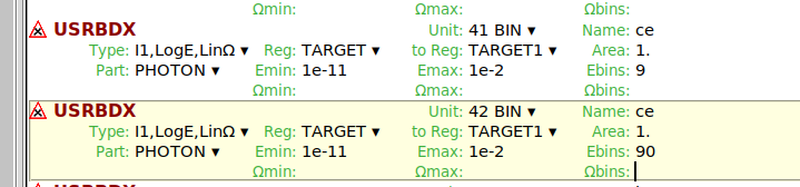

I want to set the energy boundaries to linear separation at different orders of magnitude in USRBDX card, just like "1e-5, 2e-5, 3e-5,…, 9e-5, 1e-4, 2e-4,…,9e-4, 1e-3, 2e-3, … "
I have set two different scenarios, as shown in the following figure. And the results are listed in the last two figures.
1
But this is not the energy gap I want.
Li
Dear Li,
it is not possible to have custom binning with built in scorings of FLUKA. They always will be uniform in linear or logarithmic scale.
To achieve the binning you want you need to set up separate scorings with linear binnings.
