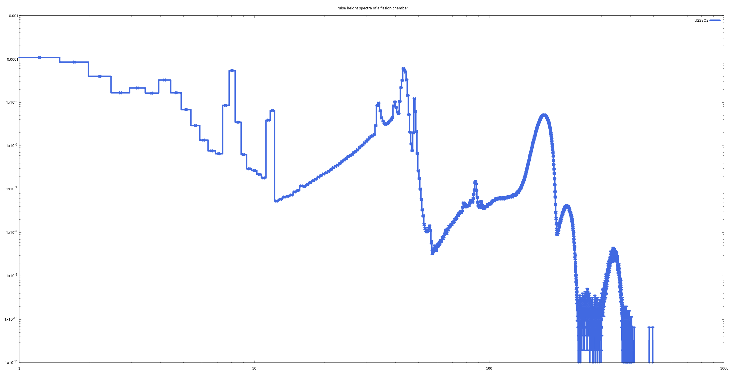

I am trying to simulate energy deposited by Fission Fragments in a test Fission Chamber made up of U238. I am using DETECT card to understand how energy is deposited by each event in the coating material or ionising gas. In the U238 coating material, the max deposited energy per event goes up to ~400 MeV. Is it due to fission created by secondary neutrons? If so, can I score the number of fission produced by primary and secondary neutrons separately?

With your DETECT card, you are scoring the energy deposition per event, where “event” refers to the energy deposited in one or more DETECTOR REGIONS by one primary particle and its descendants (continues on the manual).
Therefore, yes, primaries and all kind of secondaries (including particles emerging from fission, like energetic fission fragments) contribute to your scoring.
