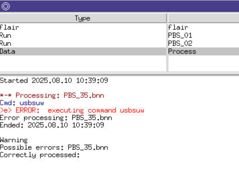

ERROR: executing command usbsuw

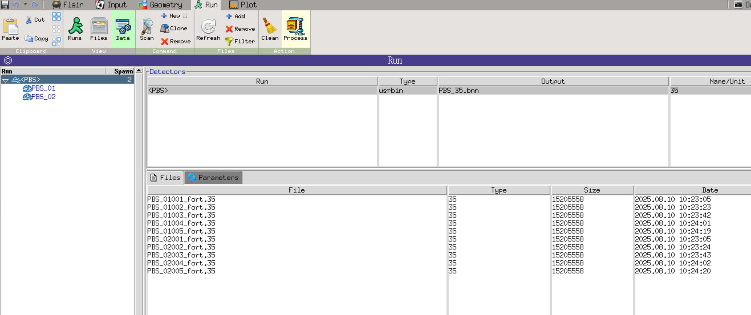

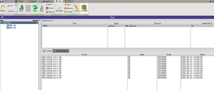

When I process data bin, error:executing command usbsuw
PBS.inp (11.9 KB)
Dear Jin,
please check if the usbsuw executable exists in the binsubdirectory of your FLUKA installation.
If it does, please try running it from the command line to see what error message you receive.
Thank you!I find out it.
