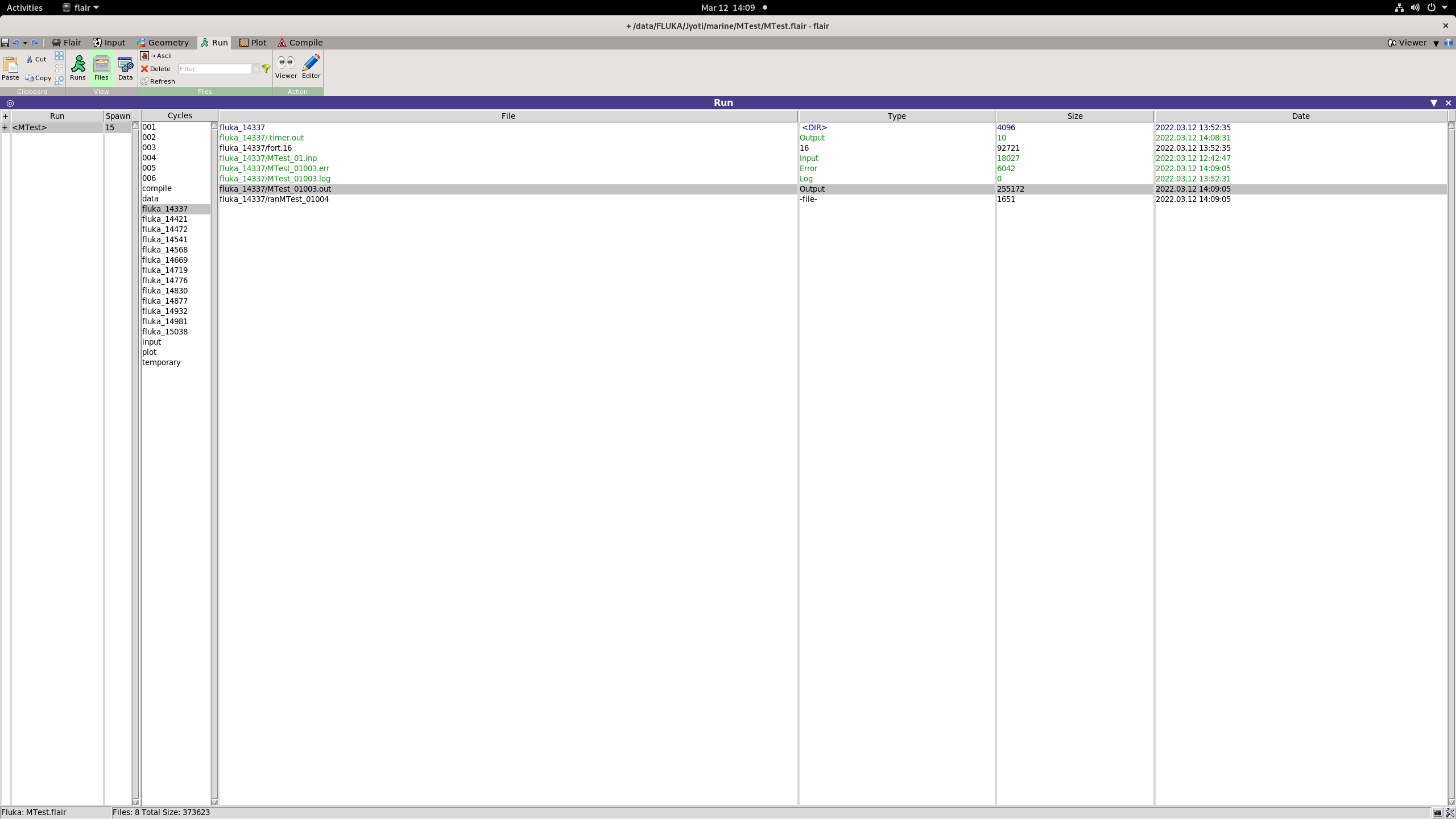

But, when I run more than one cycle, Progress Status shows “Finished with errors”. The screenshot of the error is attached here.
I checked the .out and .log files. No error was generated. I ran the input with 10spawns and 2 cycles, but only 19 files were generated (screenshot attached).

The input file and source file is attached. MTest.inp (17.6 KB) M1.f (13.1 KB)
I ran 5cycles, 15 spawns with NPS:5E+07.
Total 29 files are generated and it is finished with errors.
