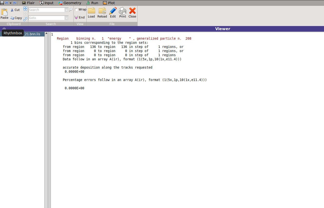

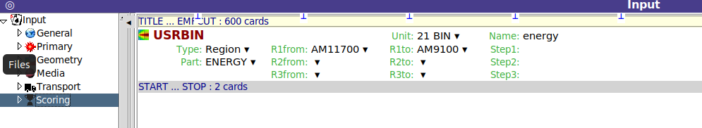

  2. If no spawn is used, it ran (tested with lower history). However, the usrbin ouput showed single value (attached), instead of all the regions. Do I need to score different variable for mesh phantom?
