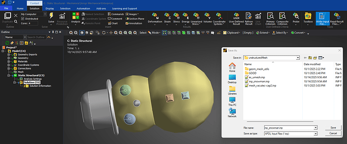

Here is my attempt with the snowman example, which was provided in the geom_mesh_utils package. I have first generated a mesh of the CAD file in Ansys and then wrote the “Solution” to an input file (see below). Then I attempted to bring the Ansys-generated input file into FLUKA via the UMESH card but encountered error messages, which I am unable to make much sense out of. Any assistance or advice would be greatly appreciated - thank you!

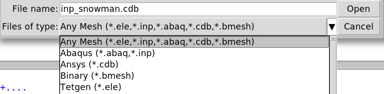

The problem is that Flair treats this file as an Abaqus mesh due to the extension:
Simply change the extension of your mesh to .cdb

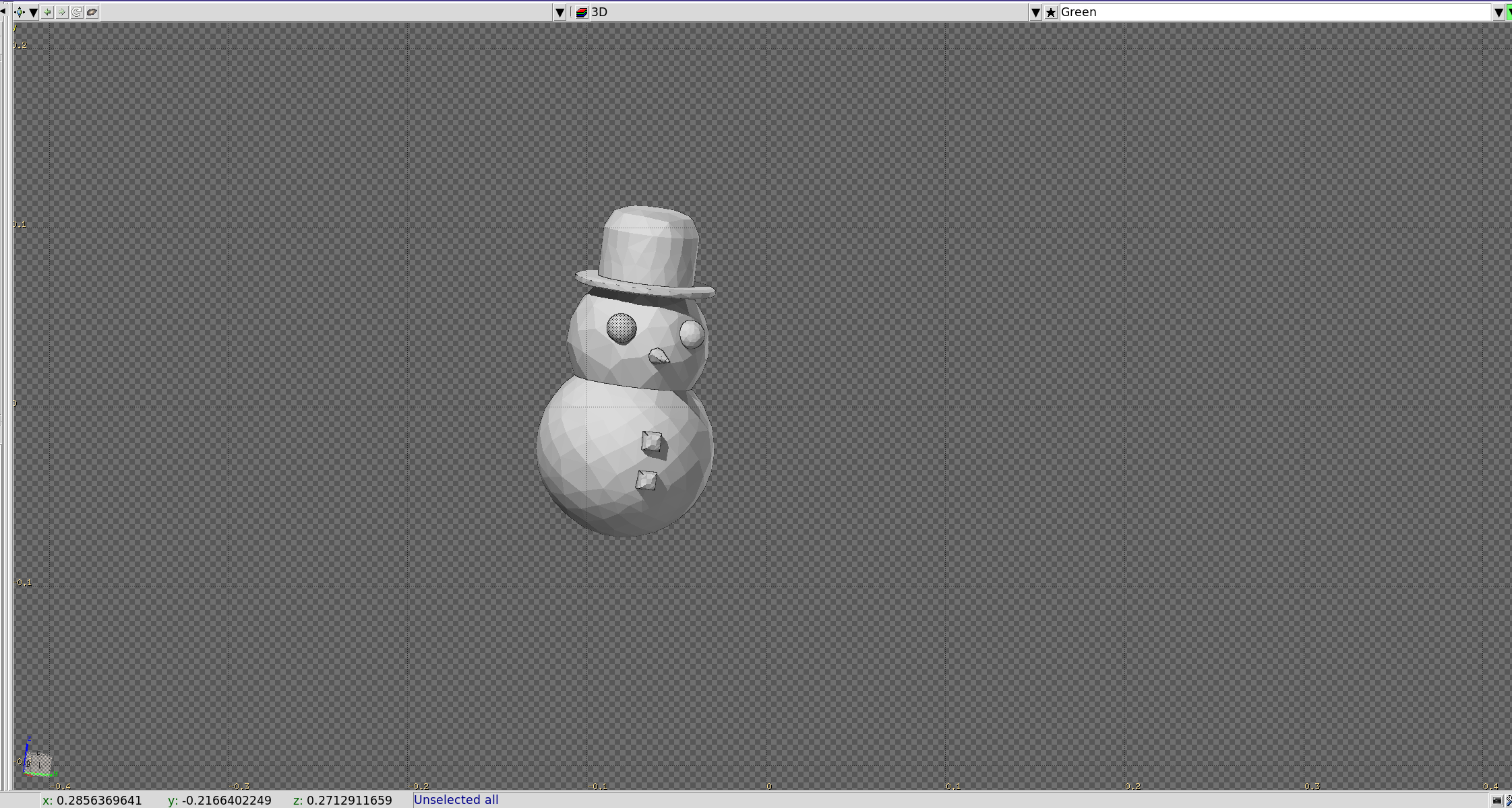

Thanks for the advice! It is as you say, and now it is time to irradiate my snowman. :snowman_without_snow:
