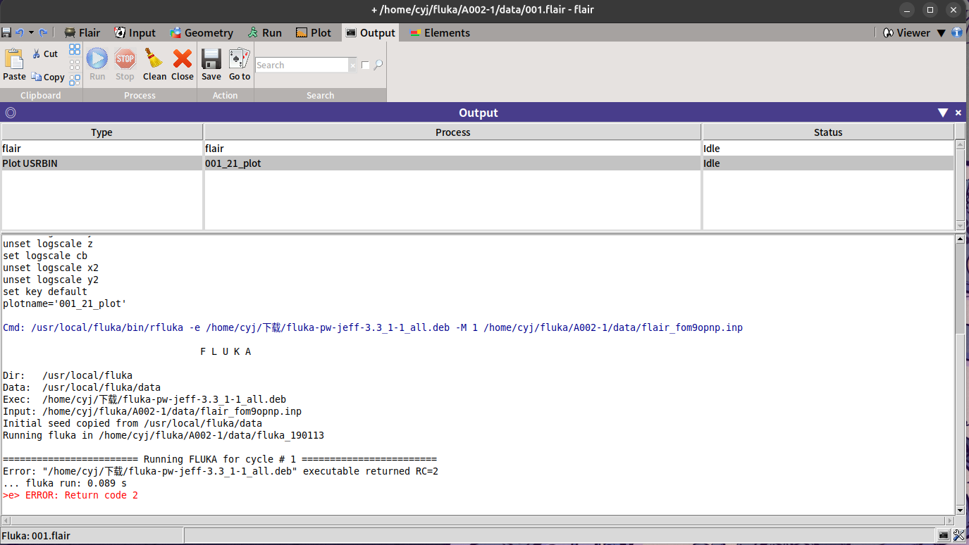

Dear Experts:

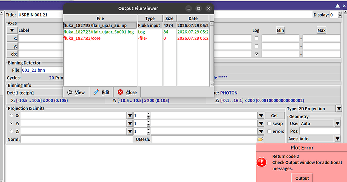

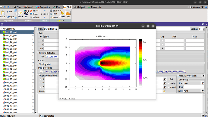

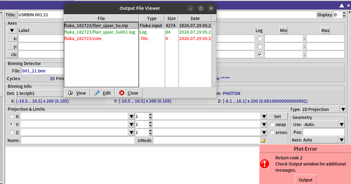

I am a new user of Fluka/Flair. I am a student exploring how to use them on my own. The previous runs went smoothly, but when I ran flair to create a contour plot, an “ERROR: Return code 2” error occurred. However, when I set the Geometry option to “No” in the Plot interface, the image appeared normally. I want to display the geometric position on the output image. How can I solve this problem :face_with_spiral_eyes: .

Dear Yijin,
Based on the first image, it seems you try to use the fluka-pw-jeff-3.3_1-1_all.deb package as your FLUKA executable.
Please check the run tab or the FLUKA tab in the Flair’s configuration.
Dear David:
Thank you! You accurately pointed out the location of the error. After I changed the executable to “fluka” in the config, the geometry was successfully displayed on the cloud plot! Thanks again for your help!(^v^)!
