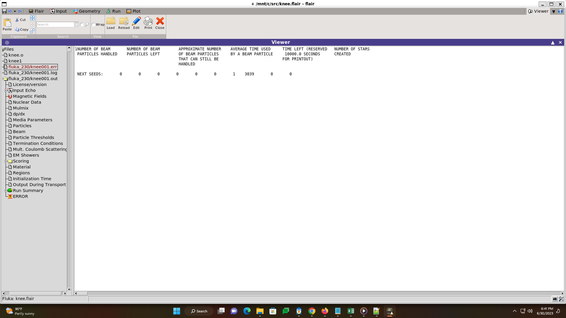

Did you look into the .out, .err, and .log files?
I show but i did not understand. i attached here some files
knee.out (509 Bytes)
PABITRAknee(VOXEL).out (549 Bytes)
Dear @sharmaram,
You have to look at the knee001.out file. Please, have a look at slide 24 from the “Standard output, common errors & mistakes” lecture from the Fluka course to see how to visualize the error message.
The reason of the problem appears quite clearly in the .log file you have visualized in your last screenshot:
In your knee.f source user routine, you have defined the array a with 83499 elements. Then, on line 28003, you select its element #172312, which makes no sense and indicates a flaw in the index identification logic.
