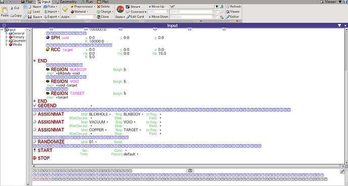

However, the interface of the flair seems not normal, show as follow:
Best, songhg

It seems now that you have an issue with the fonts.
Please give a look at this thread
and let me know if this fixes it.
Best, Luigi
Dear @luillo
Thanks for your help. Both the problems are fixed.
  1. The problem described the 1st post still remains after re-installing the MacPorts, so the OSX is re-installed.
    2.SF-mono has been selected as the default font for “input comment” and “input fixed”.
Thanks!
