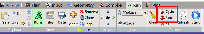

You need to create the fluka.stop or rfluka.stop in the directory where you started the FLUKA simulation.
Or, if you are using Flair you can use the following buttons:

Dear Mustafa.
These will stop the currecly running simulations. Then you can start new jobs or additional cycles.
