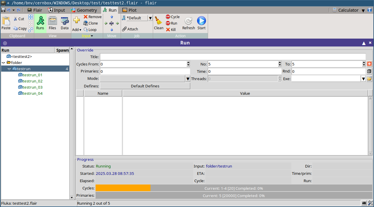

Hi @Dirk_Bartkoski
I am not able to reproduce it. I did the following:
  • opened your flair file
  • added a run folder/testrun
  • set to 4 spawn jobs
  • click Start
    and I got the following file structure

Can you please verify that the
Config β†’ Run β†’ Spawn Run Name
has the default value \I_\2
I checked the Spawn Run Name and found that, while the default value was \I_\2, Flair is not responding to modifications to the Spawn Run Name input.
It doesn’t matter what I try to use for the Spawn Run Name, it saves all the spawns exactly as before.
I think what I want is \I/\I_\2 so all the spawns will be saved into a new directory whose name is the run name.
