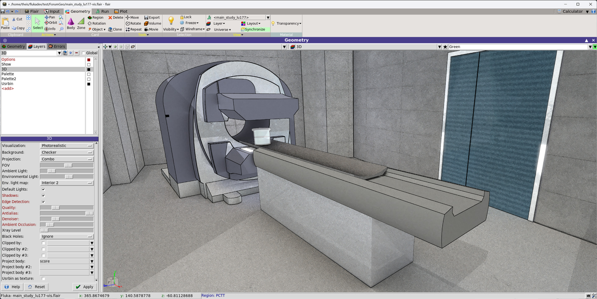

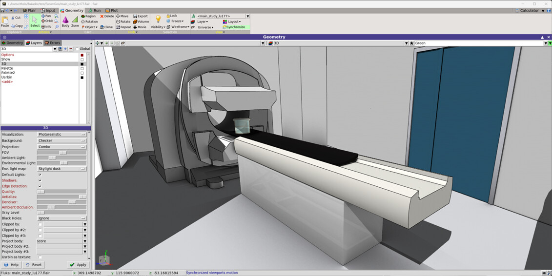

If you allow me, then I would just like to add some general remarks looking at the 3D settings that you apply. In order to have photorealistic quality there is no need to move the slider to the most right position. Moving it already one notch to the right is sufficient for 99% of the cases. If you increase the setting further the number of photon scatterings that the renderer follows up, is increased. However, the visual impact is often very subtle and render times increase exponentially!
You have also set the ambient occlusion slider to the most right position. This will give you the best quality but comes at the cost of runtime. Due to some clever math, moving it to a position of 1/3 or 1/2 of the total range is often already sufficient. You might still see some visual noise but with the new denoiser this can be taken care of in a much quicker but less accurate way. See the following examples:
Ambient occlusion ~1/3 of max:
Ambient occlusion 1/3 with denoiser:
Ambient occlusion at max:
Unless you are a graphics professional I don’t think you will see a notable difference between the first/second and the third one which takes much more time to compute.
As you can see below with the screenshot, you can already get decent results at much lower rendering times:
