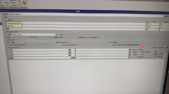

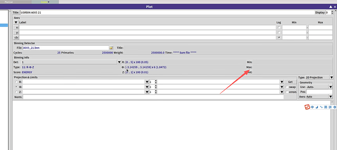

flair version 3.4.3 does not display min,max, and int in plot.As shown in Figure 1, Figure 2 is my screen display, without the above-mentioned content. May I ask how it should be set up. thank you!
Dear @1159198314

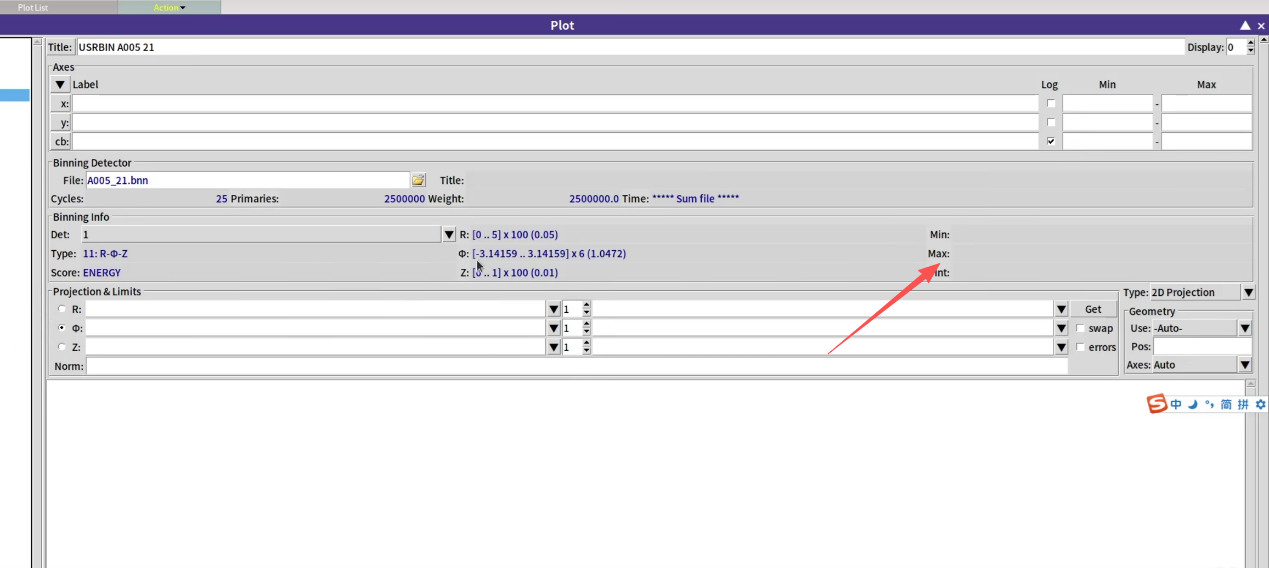

indeed the Min,Max,Int were removed from the last version of flair. The reason was that the information was updated only after a plot using the obsolete gplevbin program, and it was creating confusion to what exactly it represents.
The last flair version uses a new program to process and display the data meshtk
You can always display the min,max,int from the command line using the meshtk program with the command
meshtk [usrbin-filename]
