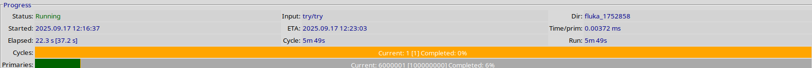

Flair starts the simulation but does not update the status or progress.
FLUKA:3.43
Flair:4.5
Operating system:Ubuntu 24
Sometimes, on certain setups, Flair initiates the run but does not show any progress. The simulation is actually running in the background. I have attached all input files, a screenshot from Flair, and the contents of one of the running simulation folders with all logs. The same Flair installation works fine with other types of .inp files, so I suspect the issue lies in this particular setup, but I cannot understand what exactly is causing it.

Hello, and thanks for the answer. Attached source.f . I must underline - the simulation actually runs ok. All files are produced correctly. It’s just Flair does not show any progress (so basically this is just a matter of inconvenience because I need to manually check the file progress).
source_newgen_neutrons.f (18.9 KB)
In some other setups (usually where less custom-made materials were involved) Flair shows progress correctly.
The number of primaries does not influence this. The Flair just keep showing the status “not running” while the simulation is actually running.
