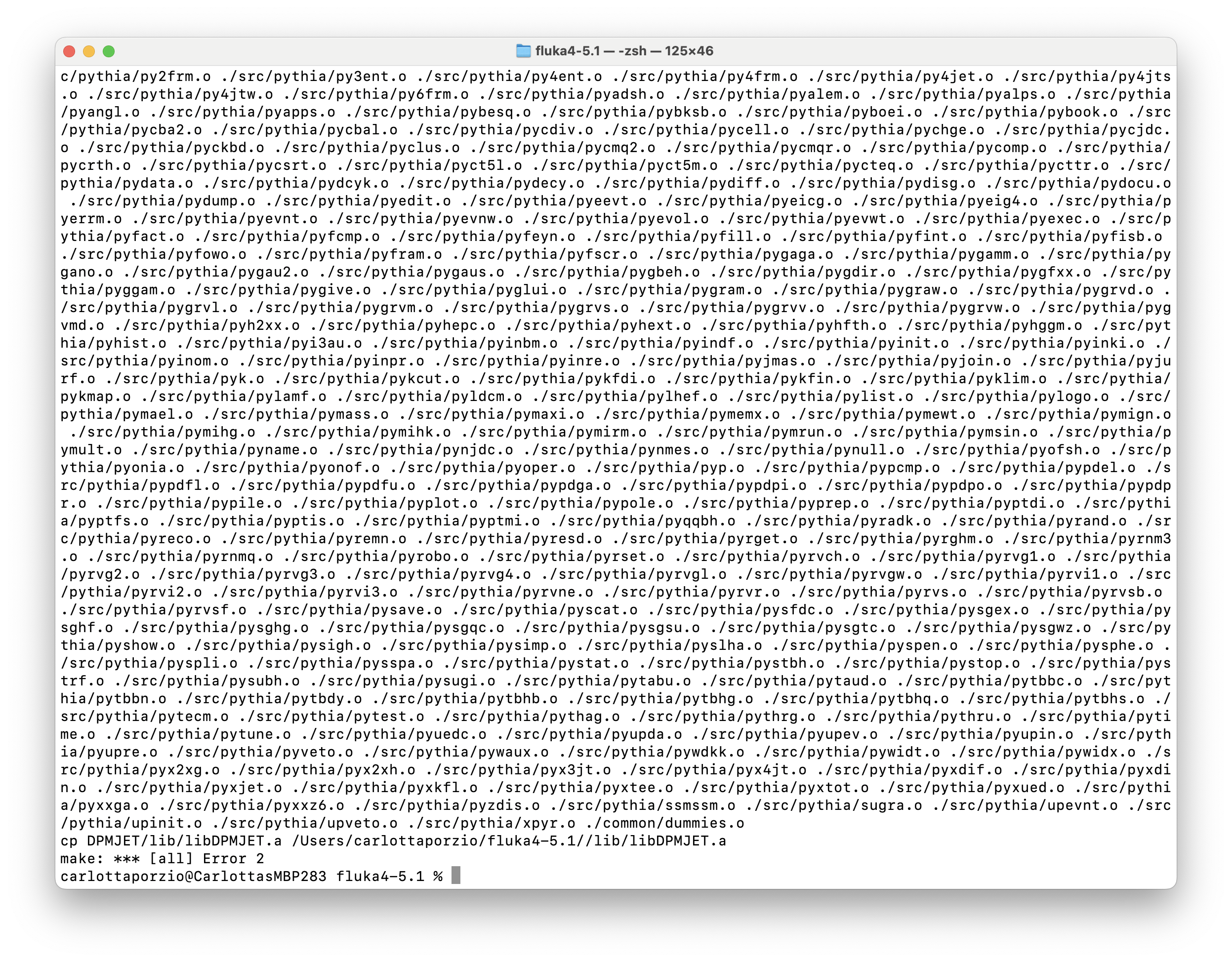

Regarding the error when compiling from source – yes, that’s the only thing I can identify as an error. There are a number of warnings printed at the start of the compilation process, then a number of normal-looking outputs (I believe), and then the one-line error. Please see attachment with a screenshot of the last portion of the printed lines.

starting from last point, the last line make: *** [all] Error 2 simply indicates that there was an error in the compilation and you should scroll through the terminal output up to find the first occurrence.
