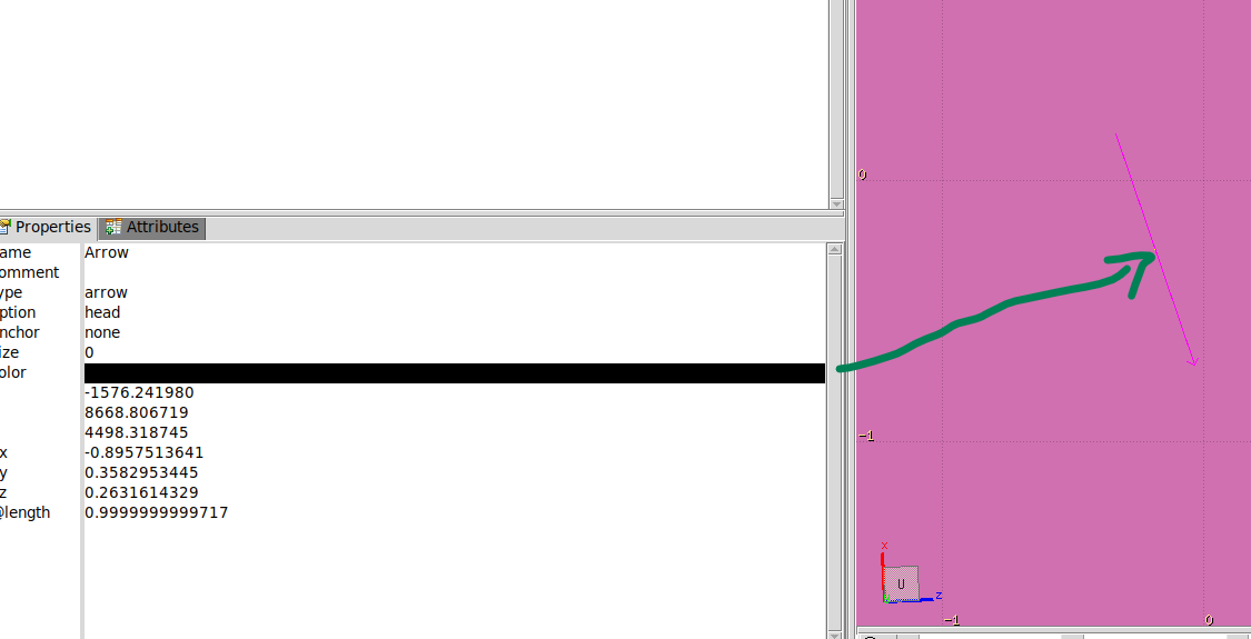

  • In the past, GEOFAR errors were noticed and the code could not recover as the error(s) is/are repeated and fatal. Even by drawing the arrow Object in the Geoviwer, no erroneous area is noticeable.. However I thought these would be finally corrected by removing all duplicated planes.

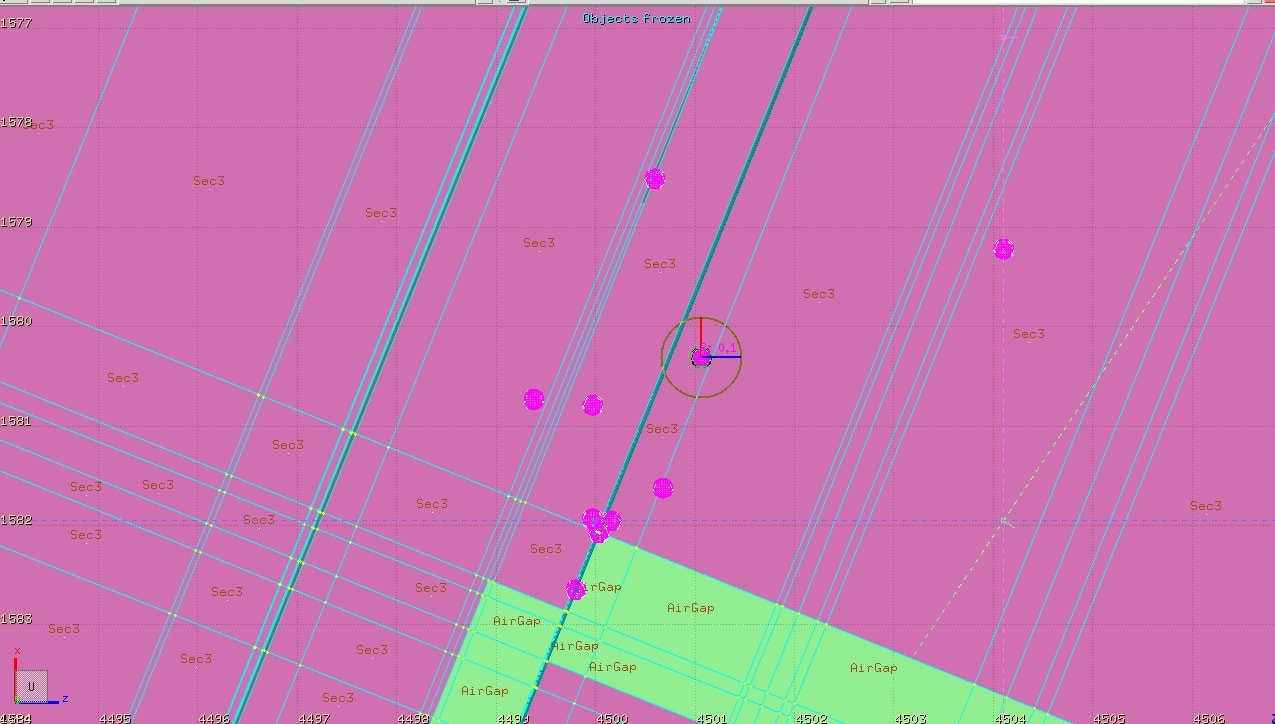

When I run my input (attached), I get one of 3 errors:
  • GEOFAR errors – these are the small geometrical errors which lead to numerical imprecision in the tracking. If one looks at these errors and adds them as arrows in the geoviewer, one sees that they don’t correspond to anything - they are not lying e.g. on the border of planes, they are in the middle of a region (as shown in the screenshot)
  • Runtime errors: Segmentation fault (core dumped) ${EXE} 2> $LOGF > $LOGF fluka run” or (“Seed file not accepted: or corrupted…”
  • Regarding the cluster issue – I am able to run other input files there so the issue must be exclusively in this input
The GEOFAR errors can be overcome by setting the accuracy parameter to 0.1 in GEOBEGIN (this was tested for 100k particles, maybe with more histories, more errors shall emerge)

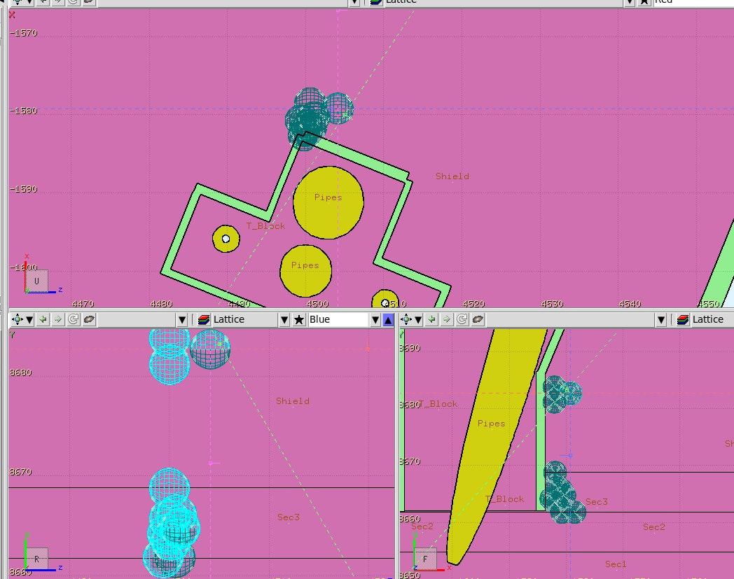

the realisation for the plane technique came when plotting the errors. Most of these errors occur where the density of planes is high (see pink /green spheres centered on the error points)
I think this method has worked and I consider the problem solved!
