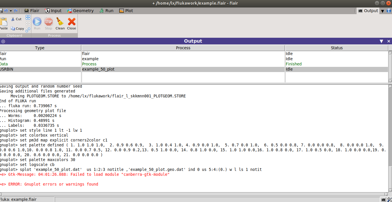

Dear Flair Creators:
I installed FLUKA and flair,then ran the example. But when I use the plot function, I get the prompt in the figure, I don’t know what’s wrong.
Li
Hi Li,
this is not a Flair issue, but a package seems to be missing from your Ubuntu. Use the following command to install it.
sudo apt install libcanberra-gtk-module libcanberra-gtk3-module
