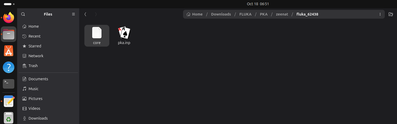

Dear Expert,
Thank you for your guidance. I checked the directory you mentioned:
/home/zeenat/Downloads/FLUKA/PKA/zeenat/fluka_62438/
However, there is no file named pka001.log or any other log file in that folder. The directory only contains this files that shown in the figure below and the core file is empty.
