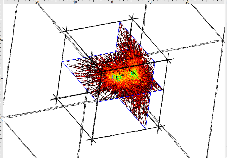

The problem with your routine is that you didn’t declare the variable “random”. You could have seen a clear error message in the output window after failing the compilation.
Once you declare the variable, the routine compile and the executable is generated.
If you run it, you would get this particle fluence distribution:
