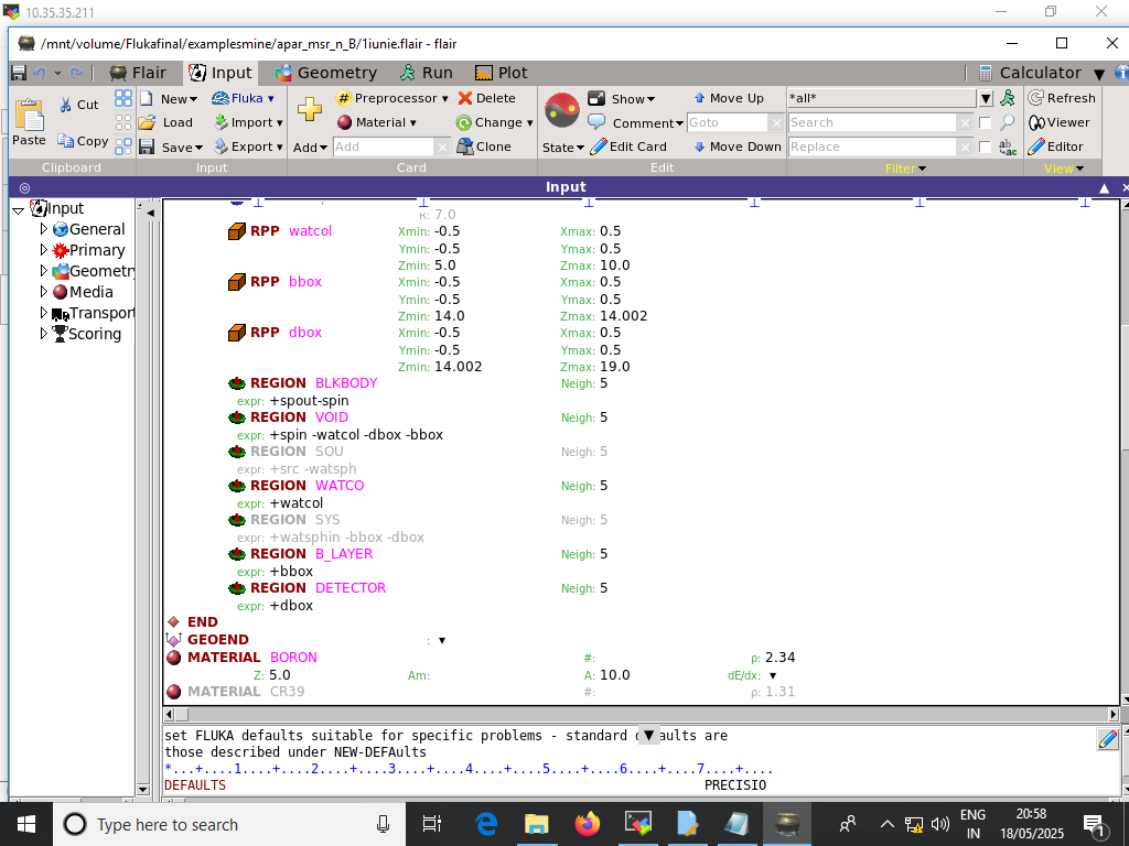

I am currently modeling a system where an isotropic Am-Be neutron source is placed. The emitted neutrons pass through a water column for moderation and then interact with a boron layer coated on a plastic substrate, where I expect (n,α) reactions to occur, producing alpha particles and Li-7 nuclei.
The scoring setup includes:
  • USRBIN detectors to record particle track-length fluence.
  • I was able to successfully score He-4 using USRBIN.

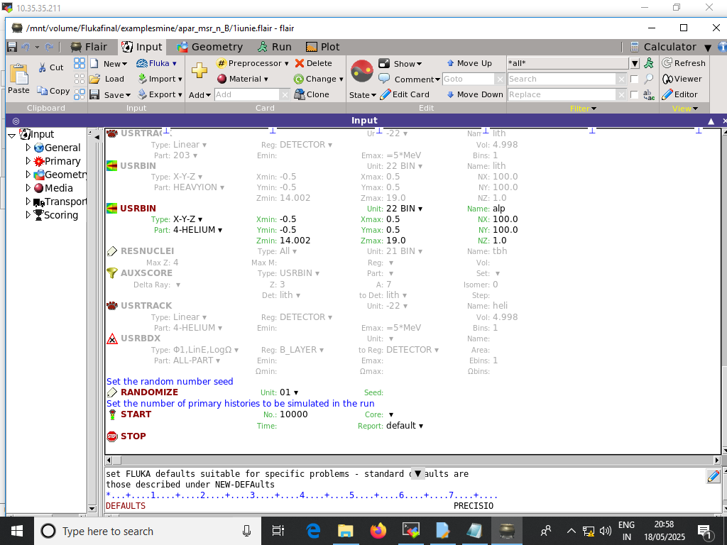

  • For Li-7, I used AUXSCORE to filter HEAVYION by Li7 (atomic number Z=3, mass number A=7, isomeric state M=0), but surprisingly, no lithium appeared in the boron or plastic regions — not even when scoring the entire geometry volume.
Could anyone please help me understand:
Why Li-7 is not appearing even though He-4 is observed?
in the above screenshot you can see USRBIN and AUXSCORE card I used for Li7 scoring. But disabled.
This is the plot for Helium. Similar plot for Lithium gives blank
Any guidance or suggestions would be greatly appreciated!

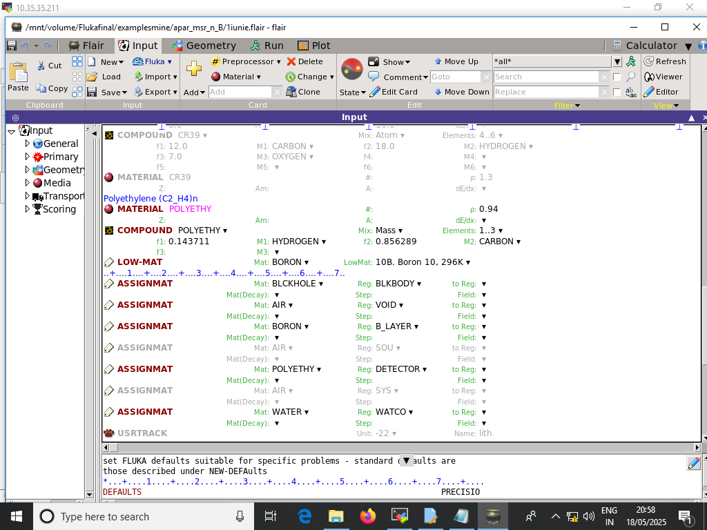

Dear @akshad997,
I think the IONTRANS card is missing in your input file. You need it to activate the transport and interaction of ions heavier than 4He. Note that you have to run with the flukadpm executable or link DPMJET and RQMD if you need a custom executable.
Davide
