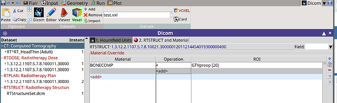

One possible thing you can try if you have an RTSTRUCT information you can assign a unique material/region to the RTSTRUCT inside the voxel. This can be done by flair when you create the VOXEL file, and then use that for scoring.
From Dicom → Voxel → 2. RTSTRUCT and Material
Select the material and create a boolean operation on the ROI you are interested.
Flair should create a unique region there with a common material
The materials are taken from the material database
