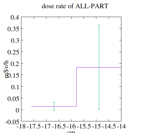

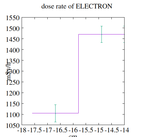

How to understand that the contribution of Dose-eq from ALL-PART is less than from ELECTRON?
When calculating the residual ambient dose equvalent rate using AUXSCOR and DCYSCORE card , it was found that the total dose rate of ALL-Part is less than of electron.How to explain it?Looking forward to the expert’s response.

Dear Yongguang,
The AUXSCORE cards for electrons have the incorrect scoring associated with them.
Dear Dávid,
Do you mean it cannot obtain contribution of electrons by filtering ‘ELECTRON’ or it improperly use AUXSCORE? So what is the correct way to score?
Dear Yongguang,
Of course, you can get the contribution from electrons, but you need to use the correct scoring names.
Currently, the last three AUXSCORE cards overwrite the first three, because they have the same detector names.
Dear Dávid,
Thank you so much. What a stupid mistake.
Yongguang
