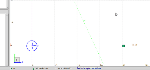

I can’t understand where I am making a mistake.
The task is to solve a simple problem:
A source of 14 MeV neutrons. A detector in the form of a cubic plastic A-150 with a side length of 1 cm located at a distance of r = 40 cm from the source. How long will it take for the detector to accumulate an absorbed dose of D = 5 Gy if the neutron output from the source is N = 5e11 n/s?

FLUKA calculation gives a result of about 3 hours:
The result of the calculation by the USRBIN command with What(2)=DOSE - 3.5781e-08 GeV/g/pr for the detector in the form of a cubic with a side, equal to 1 cm
  1. 3.5781e-08 * 1.6021764e-07 = 5.73e-15 Gy/pr (USERBIN, Note 5)
  2. 5.73e-15 Gy/pr * 5e11 pr/s = 2.87e-3 Gy/s
  3. 5 Gy / 2.87e-3 Gy/s = 1742 s = 0.5 hr
224 hr vs 0.5 hr. I don’t understand where the error is.

I rather find (P. Pihet et al, 1992, Phys. Med. Biol. 37 1957) a value of 6E-11 Gy * cm^2, giving ⪅ 1 hr.
FLUKA win, again! Thank u!
