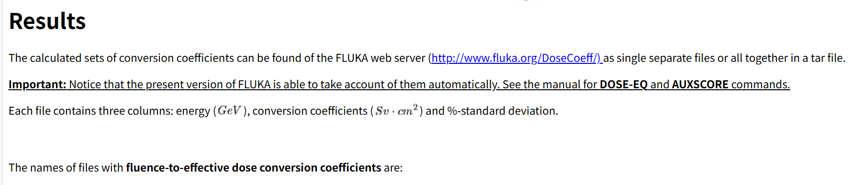

I hope to receive assistance from experts, scholars, or official personnel! I previously read a FLUKA article titled “Overview of Fluence-to-Effective Dose and Fluence-to-Ambient Dose Equivalent Conversion Coefficients for High Energy Radiation Calculated Using the FLUKA Code.” The article mentioned that the website “http://www.fluka.org/DoseCoeff/” provides data files related to Fluence-to-Ambient Dose, but this URL is now invalid. Is there any way to find these Fluence-to-Ambient Dose data files?
