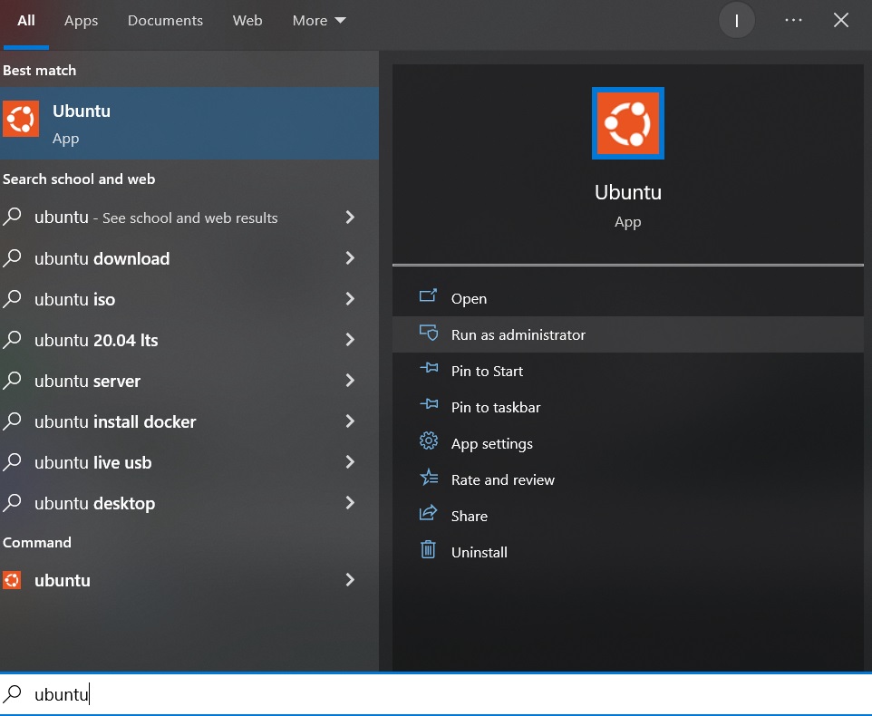

when I type ‘Is’ in the terminal it says command not found. I am a bit confused what ubuntu is using as the main directory. I haven’t installed anything from fluka yet, so I just placed the .deb file on the desktop.
Did you try ls after opening the terminal with right click on your Desktop → open terminal?
No, I opened it like this and run it as an administrator.
Dear Ines,
your commands have typos in them:
  • the correct package name is fluka_4-2.2.x86-Linux-gfor9_amd64.deb
  • the command to list the content of the directory is ls (lower-case L, not capital I).
You may want to take a look at a tutorial on Linux, like this Linux Tutorial for Beginners - Learn Linux and the Bash Command Line to get familiar with the basic commands.
The WSL Linux uses the complete separate filesystem by default. You can access your Windows drives via the Linux directory /mnt/...
