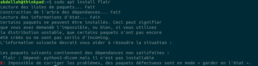

when i tap this command
sudo wget -q -O - https://cern.ch/flair/download/ubuntu/KEY.gpg | sudo apt-key add -
i have this message
Warning: apt-key is deprecated. Manage keyring files in trusted.gpg.d instead (see apt-key(8)) "

Did you have a look at this thread and this thread on the forum?
yes but nothing changed still have the same message error
It seems to me you have somehow mixed different installation. I recommend you to remove everything and have a clean start.
