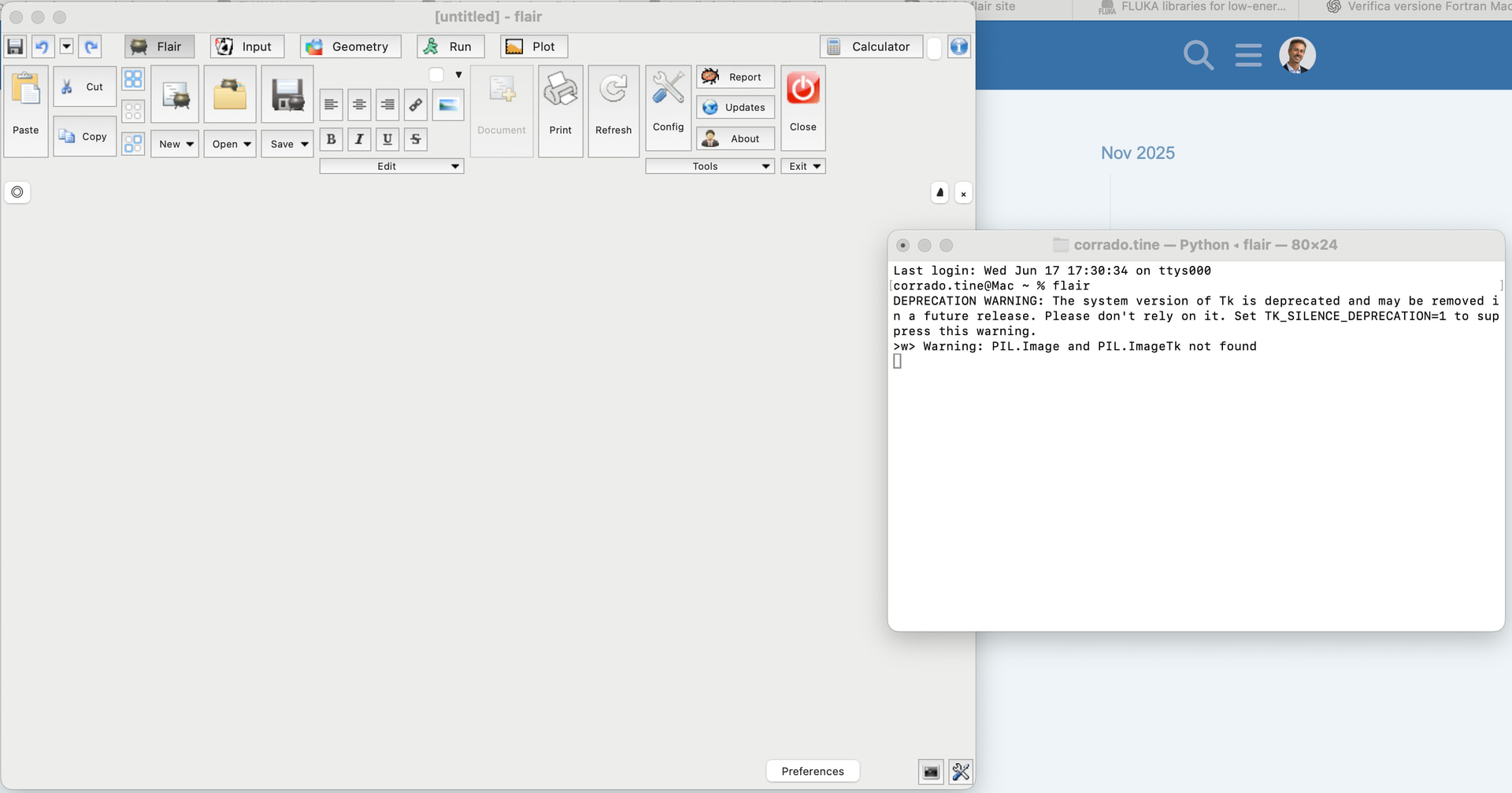

I just installed the latest versions of FLUKA and Flair on my macOS, but I think something is wrong because when I run Flair, I see what’s shown in the attached photo: flair runs but appears empty and no any action is possible.
A warning message appears in the terminal:
DEPRECATION WARNING: The system version of Tk is deprecated and may be removed in a future release. Please don't rely on it. Set TK_SILENCE_DEPRECATION=1 to suppress this warning.
>w> Warning: PIL.Image and PIL.ImageTk not found
Thank you for your help.

Thank you for your suggestion. I carried out a few additional tests and I have a better understanding of the issue now.
Initially, Flair was using the default macOS Python (Python 3.9.6 located in /usr/bin/python3). In that case, the GUI opened but remained completely empty and unusable. The terminal showed:
Following your suggestion, I installed Pillow for the default Python. The PIL warning disappeared, but the GUI was still empty.
I then noticed that the Flair documentation explicitly recommends not using the default macOS Python, but instead using a MacPorts Python.
I already have several Python versions installed through MacPorts. By forcing Flair to use the MacPorts Python, for example:
PYTHON=/opt/local/bin/python3 flair
the GUI now opens correctly. However, two things happen:
  1. The application now runs through XQuartz (which I assume is expected since the MacPorts Python uses the X11/Tk backend).
  2. The warning
appears again.
So it seems that:
  • the original empty GUI was caused by using the Apple-provided Python;
  • the MacPorts Python fixes the GUI issue;
  • however, the MacPorts Python currently used by Flair cannot find the Pillow (PIL) module.
Could you please advise which Python version is currently recommended for FLUKA/Flair on macOS Sequoia (3.10, 3.12, 3.14, etc.), and which corresponding Pillow package should be installed?
Thank you very much for your help.
