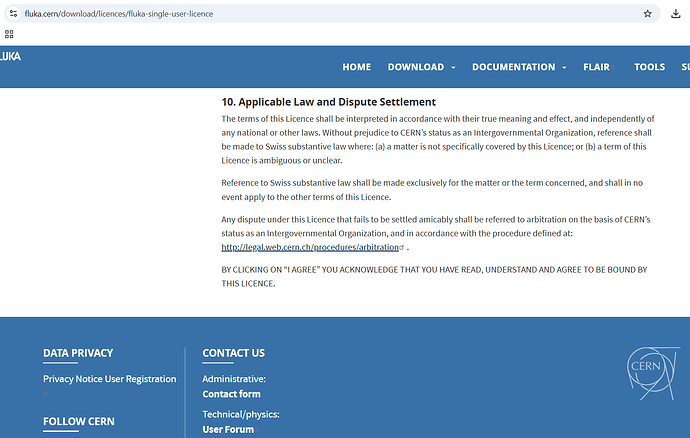

I am logged in on the FLUKA website and download the official Linux binary package(pic. 1).
However, the downloaded archive (gfortran>=9, 64 bits (.tgz)) does not contain the FLUKA executable binary.

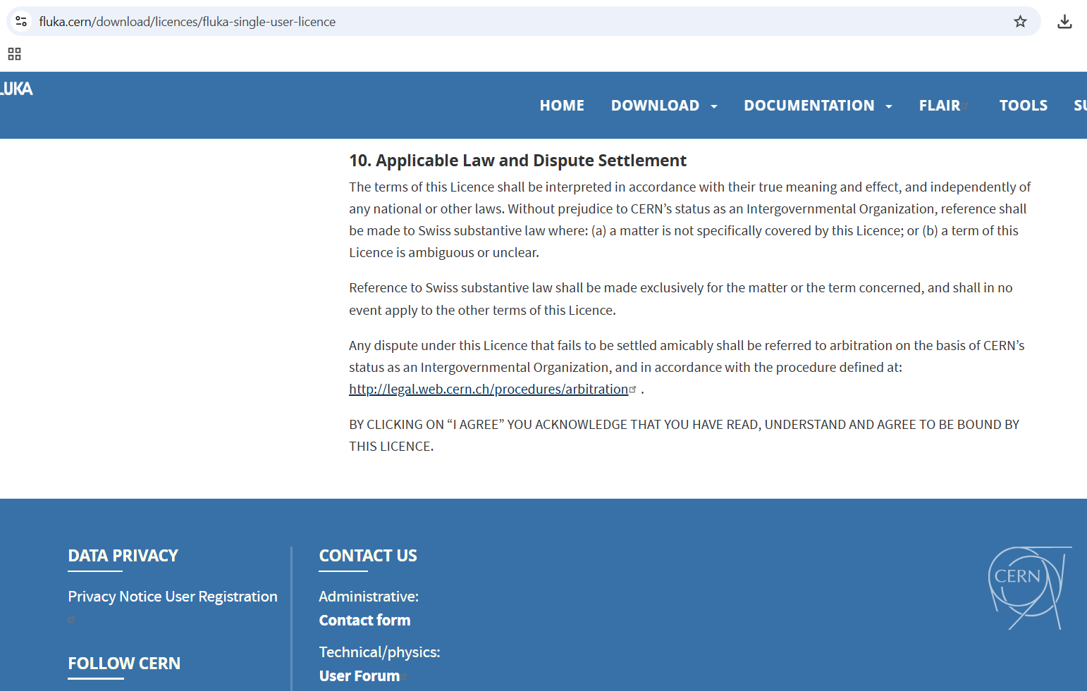

The bin/ directory only contains wrapper scripts and utilities. No fluka binary (tens of MB) is present(pic. 2).
