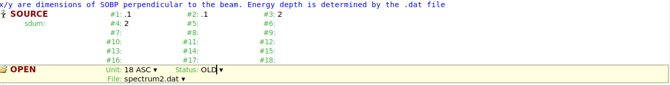

I have encountered an issue while running simulations for clinical particle beams (proton, alpha, and carbon ion) using FLUKA. My approach involves utilizing an external text file to generate a Spread-Out Bragg Peak (SOBP). I have written a source.f file to sample from this spectrum file and compiled it with comscw.f without encountering any issues. In my input file, I utilize source and open cards to define the beam of interest.

I am attaching the relevant input files and source code for your review sourcemodSOBP.f (9.5 KB) He4_SOBP.inp (3.0 KB) He4_SOBP.flair (2.5 KB) spectrum.dat (37.0 KB)
