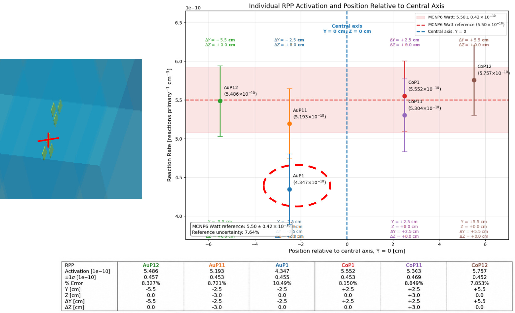

I am comparing FLUKA and MCNP activation results for several Au regions placed symmetrically around a central axis.
Since the source is expected to produce a mostly symmetric neutron field, I would also expect similar activation values at the corresponding symmetric positions. Interestingly, 5 out of the 6 positions give results reasonably consistent with MCNP, but the region at ΔY = −2.5 cm consistently gives a noticeably lower value.
I am wondering what could cause such a localized asymmetry. Could there be something specific in the FLUKA geometry, source definition, or scoring that I should check?
I attach the plot showing the different positions and results.
Thank you for your feedback.

Dear Carlos Eduardo Vítor,
The error bars for your comparison with MCNP are not very small. Perhaps you do not have an agreement within 1-sigma, but within 2-sigma it seems you have. Perhaps when doing another simulation or running more primaries you would get closer to the MCNP results.
Also, I suggest you use this routine for generating a random isotropic direction:
call sample_isotropic_direction( direction_cosx, direction_cosy, direction_cosz )
It would perhaps simplify your routine. Also, it would exclude an error in the generation of the direction vector.
Let me know if it solves your problem.
