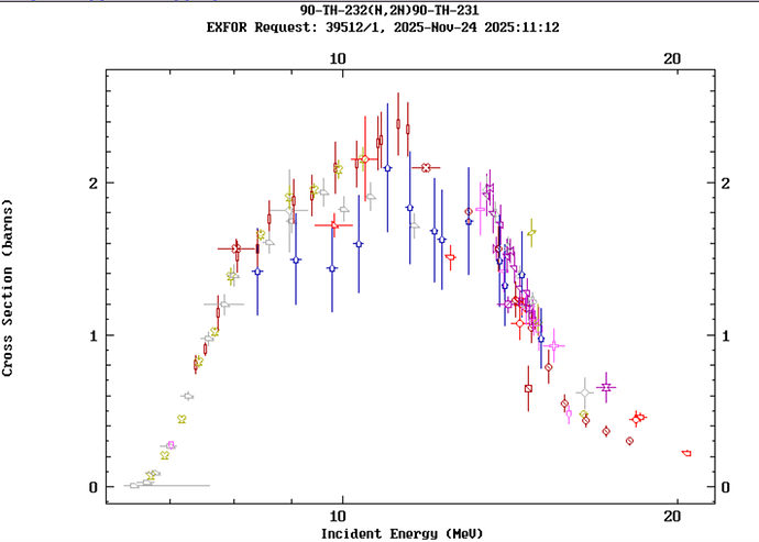

I would like to know whether FLUKA is able to simulate the 232Th(n,2n)231Th reaction cross section.
My goal is to compare the experimentally measured 232Th(n,2n)231Th cross section with the theoretical values obtained from simulations. Is it feasible to perform such simulations using FLUKA?
(This image is taken from the Experimental Nuclear Reaction Data ).

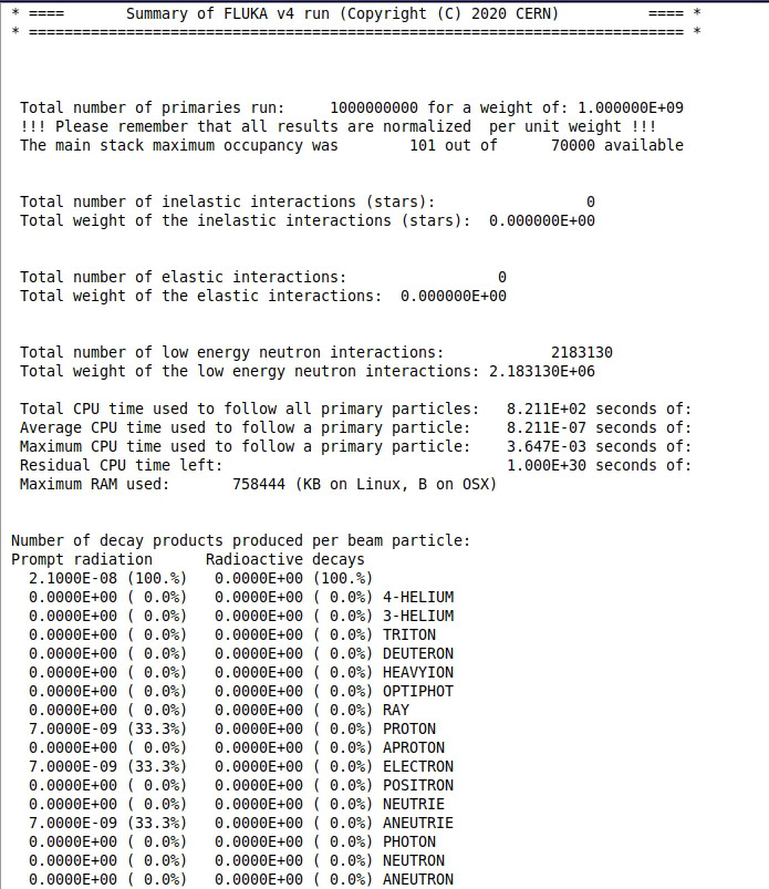

In my output file, the following message appears: “Total number of inelastic interactions (stars): 0”. I believe this is incorrect, and I am unsure whether this indicates a problem in my setup.

A few clarifications:
  • FLUKA simulates the indicated reaction channel, but is not designed to extract microscopic cross sections;
  • For low energy (<20 MeV) neutrons, there is a dedicated treatment and their inelastic interactions are not accounted as ‘stars’, hence it’s normal to read 0 there, while a not null value is reported in the respective line a bit below.

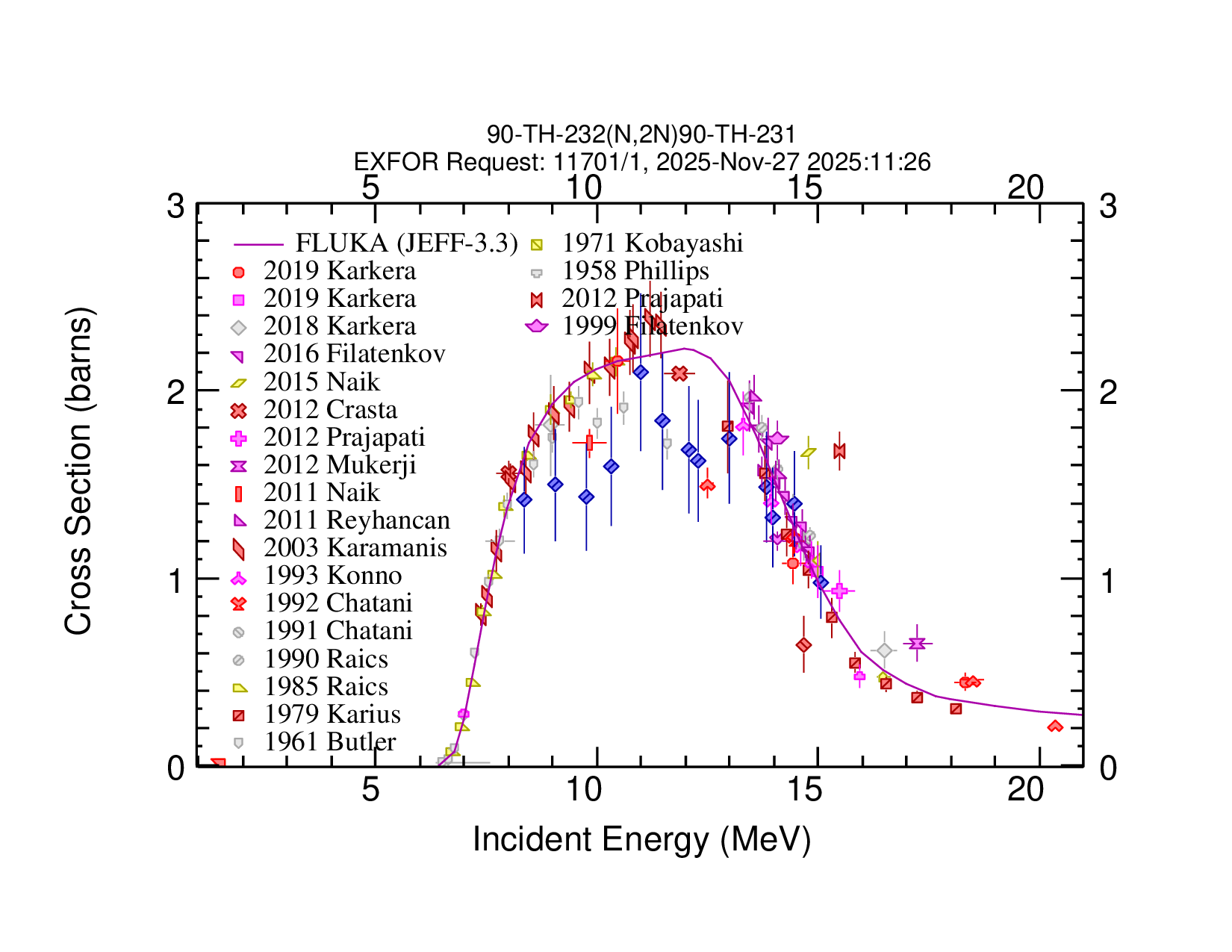

  • The aforementioned treatment is based on data libraries, hence for low energy neutrons the simulation reflects the latter and does not give ‘theoretical’ values.
  • The JEFF-3.3 (n,2n) cross section on 232Th used by default by FLUKA is shown in the following revision of your plot:
Thank you for your helpful guidance. If I would like to obtain the results shown in your figure, how should I read the .out file? I look forward to your reply.
You do not find those cross section numbers in the .out file, rather in the respective library file. For this specific case ((n,2n) on 232Th), it’s JEFF-3.3/Inelastic/F04/90_232_Thorium.z in the data/neutron directory of your FLUKA installation.
