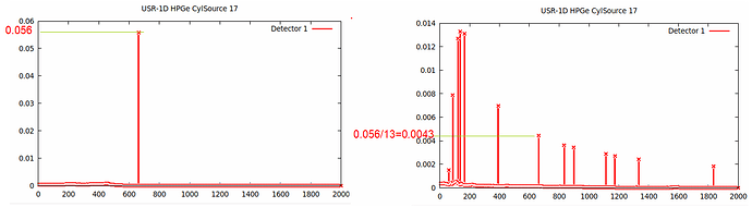

I calculated the efficiency of a detector using the DETECT card in combination with the source_newgen.f user routine. Everything works well when I use a single energy value—either directly by setting momentum_energy = 0.00066158 or by using a file (DiscreteEnergy1.dat) that contains only one energy. The results are consistent and correct.

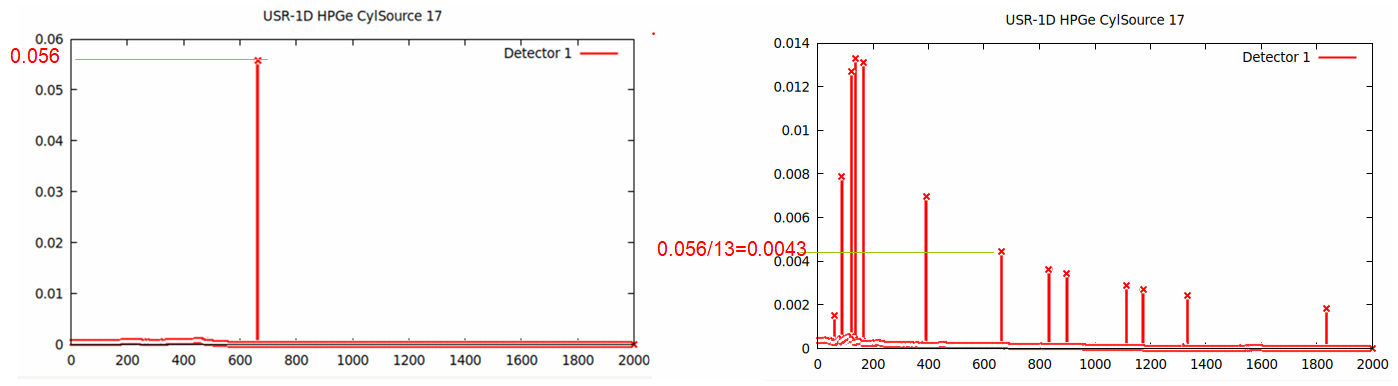

However, when I use a file (DiscreteEnergyAll.dat) containing multiple (13) discrete energies in the sample_discrete_momentum_energy function, the calculated efficiency appears to be divided by the number of energy values used. For example, the resulting efficiency is roughly 1/13 of what it should be.
Could someone please advise how to correctly handle multiple discrete energies in this context? Is there a normalization step I am missing ?

Dear @m.assalmi ,
The source routine will normalize the total porbability to 1, so you need to normalize manually the results. In this case multiplying it by 13.
